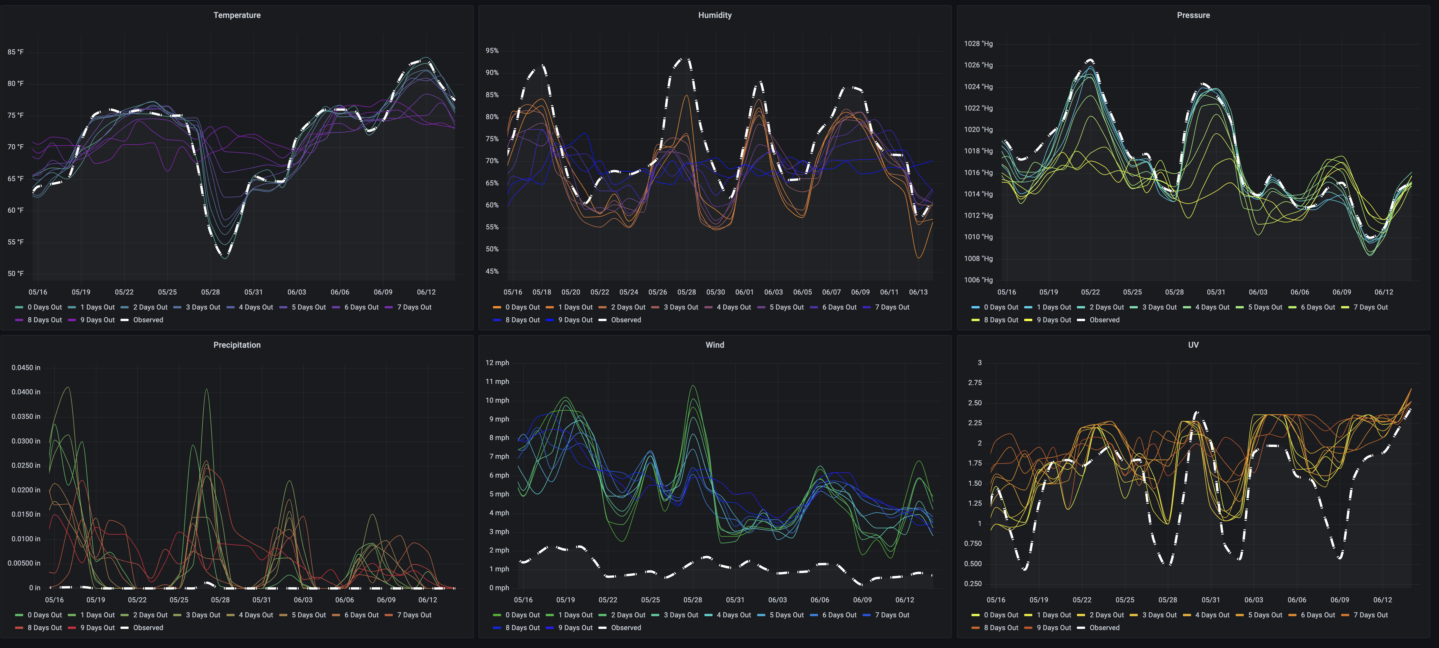

I’ve recently updated the All In One as well as the standalone collector with some additional forecast and rain dashboards. I also included a rewrite of the documentation and deployment instructions (with pictures for each of the dashboards.)
Forecast Vs. Observed:
Rain and Lightning
