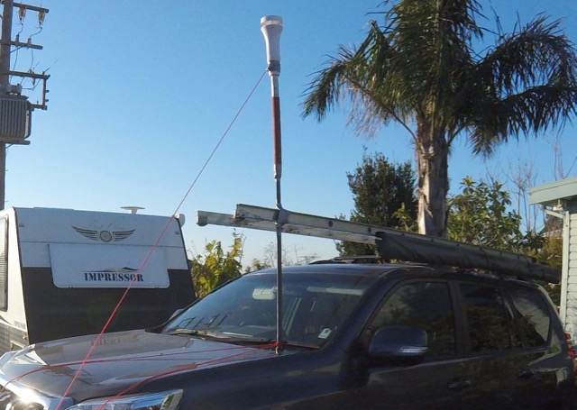

Hi @bfjewett,
I mounted the Sky to my car to test the speed calibration because several of us were not believing the output.
I used my mobile phone as a wifi hotspot and everything worked correctly.
 ![GOPR2015](https://us1.discourse-cdn.com/flex020/uploads/sws/original/2X/d/d4c612571a3856aa3b06aee941dccd7ae1814768.jpeg)
It did record lots of rain due to vibrations so I then carried out lots of different testing to determine which types of vibrations and mounting arrangements cause false rain. This forum has lots of discussion about that but my mount below is the only thing I have read to actually remove false rain from a vibrating mount. There was a moment while I was holding the simple pole out of the roof of a convertible car when it didnt record false rain at speed. So I tried unsuccessfully to replicate the angle but could not repeat the period without false rain.
So then I worked on different mounts. This mount is on a very vibrating pole but only records false rain sometimes at around 40 knots. The rubber that does most of the dampening are rubber cone adaptors used in Australia to connect a toilet to the sewer. After nearly 12 months they are cracking so I might need to replace them and paint the rubber to stop UV. The center pipe also is filled with potting mix because I didnt have sand at the time.
 ![20180921_125707](https://us1.discourse-cdn.com/flex020/uploads/sws/original/2X/f/f60ed9b740e26cdd6b3c9c6064f7e791b81a817e.jpeg)
And the mount is held at its center of wind resistance so that strong winds dont tip it over.
 ![20180921_153839](https://us1.discourse-cdn.com/flex020/uploads/sws/original/2X/e/e9b138ea81e6fe0428b6df042e9b18ae4e399f4d.jpeg)
During my driving test after weatherflow corrected an error it seemed to read accurately. The error at that time caused the speed to drop to almost nothing after about a minute of constant speed. We would be interested to hear how well the calibration is to your GPS speed.
cheers Ian 🙂
