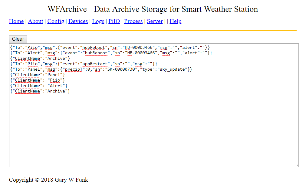

I am working on a new feature that will help you see what is going on with your system.
Capture
You will now be able see some internal activity.
