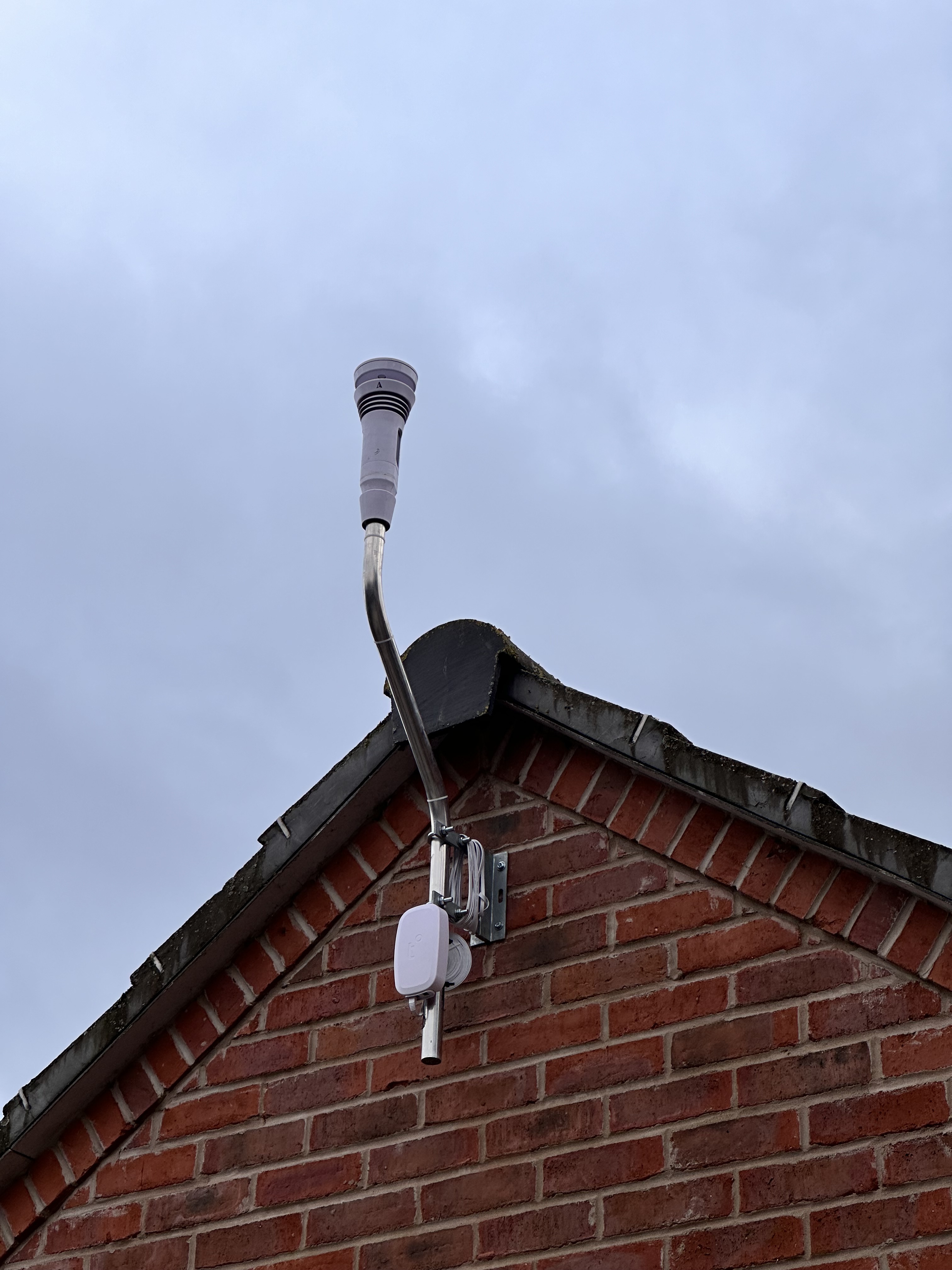

Few hours yesterday to get it back where I want it… I hate going up the ladders that high :slight_smile: Sod’s Law today very sunny this morning :slight_smile:
Why didn’t you run the wire down the center of the pipe? Also, if you can get the wire run into the attic or otherwise inside the house you could avoid the high ladder climb when the batteries need to be replaced.
Pipe is full of concrete to stop vibration and I have no power at all that side of loft space.
I wasn’t talking about power, just if it is easier to reach the loft space, the battery box could be inside. No need for the tall ladder outside when it comes time to replace the batteries.
Oh, good thinking !! When I go up to change them I’ll drill though…

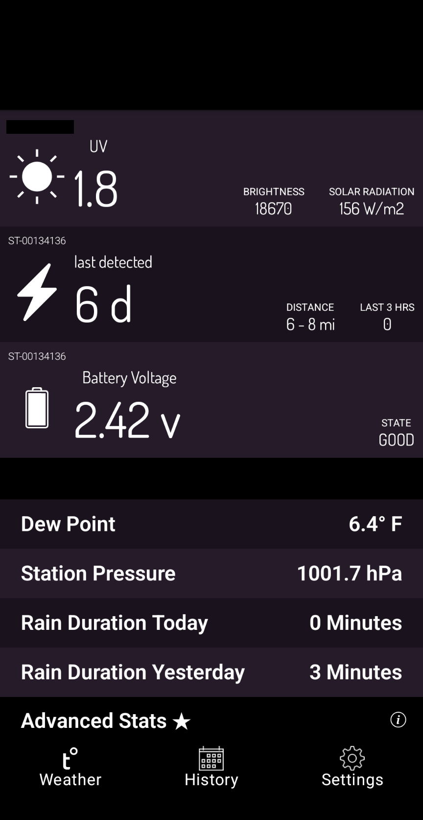

Mine has been on Mode 3 pretty much since it drained off the initial charge from the factory and has never even gotten back to Mode 2. I have been waiting for the accessory pack so that I can get all of the functionality back. That 90% number is probably a little high for marketing purposes.
I’m over in Bothell, and mine just drained right down to Mode 3 from week 1 and has never charged above Mode 3. Did you run yours for a time without battery backup, and did it charge suffiiciently?
Mine seems to have recovered over the last number of sunny days.

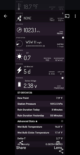

It was down to 2.38 volts (and I think I saw lower) and now it is 2.5 volts. I still want the Power Booster. But if yours is receiving sun you might have a problematic unit.

Do you have the plot for your Solar Radiation W/m^2 over that period. Mine has only ever received 288 W/m^2 at a maximum since December 25th. Even then it was a short period of time. Today is fairly sunny and the location is only receiving about 170 W/m^2. The problem is I have a large row of trees to the South of my property, so I think even with full sun I am only receiving slight periods of charging.

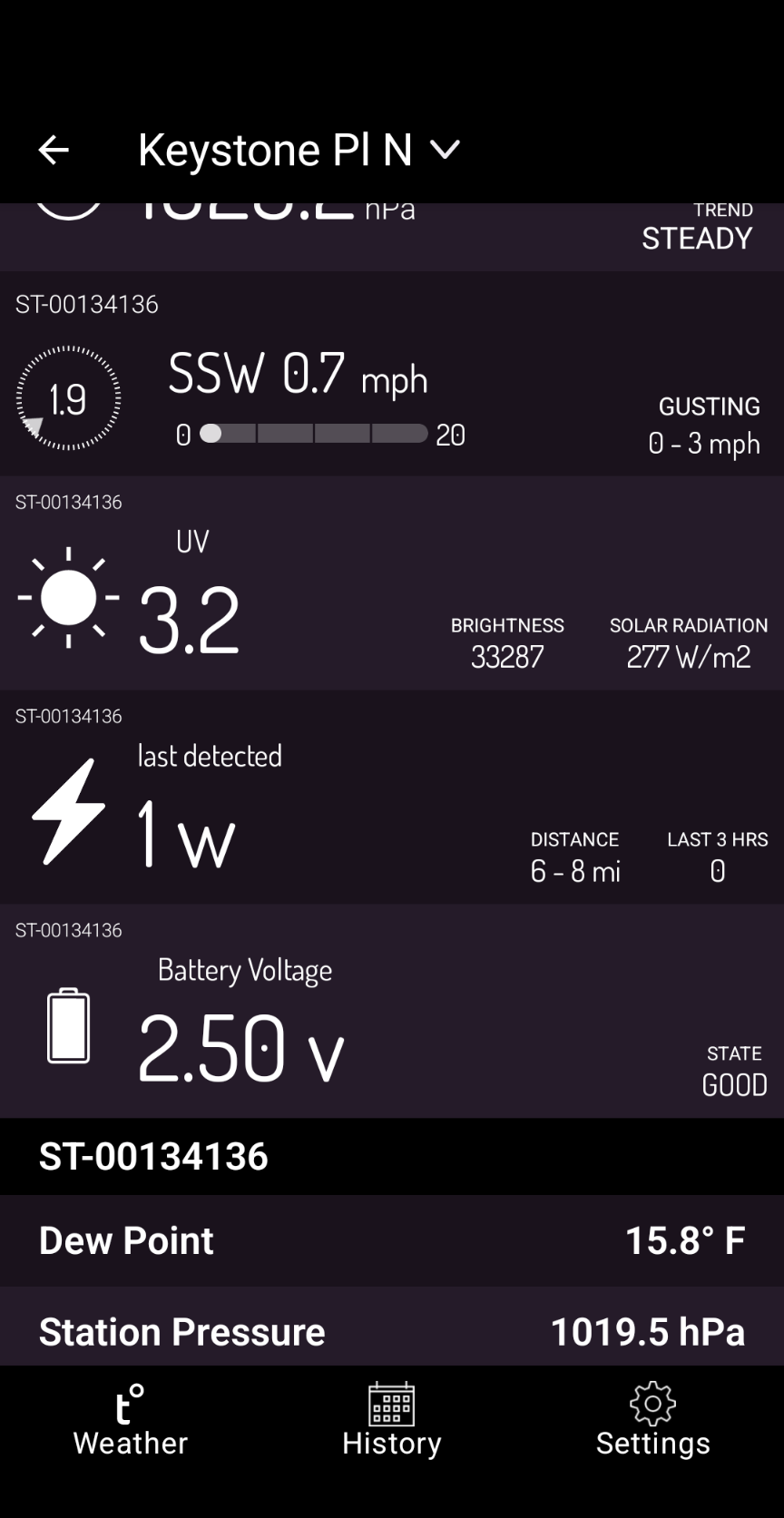

Is the solar PLOT something found in their app or do you do use a separate method for plotting sun exposure? Tempest is now 2.67. I have solar on the roof and as usual in the pacific northWET (northWET Washington) it produces and doesn’t. But it does not feed batteries.

edited to add: Oh, I see, tapping on that field shows power graph.
I will post as soon as the screenshot arrives.
Looks like your area is getting a bit more sunlight than where I am. From what I have read the unit charges when it is above 300 W/m^2 for extended periods of time. This is why I really need them to get that battery pack in stock.
