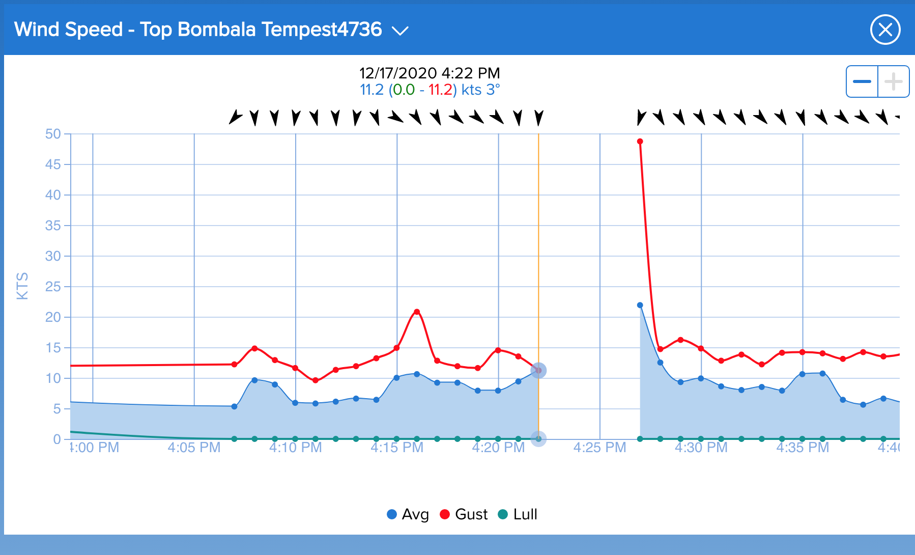

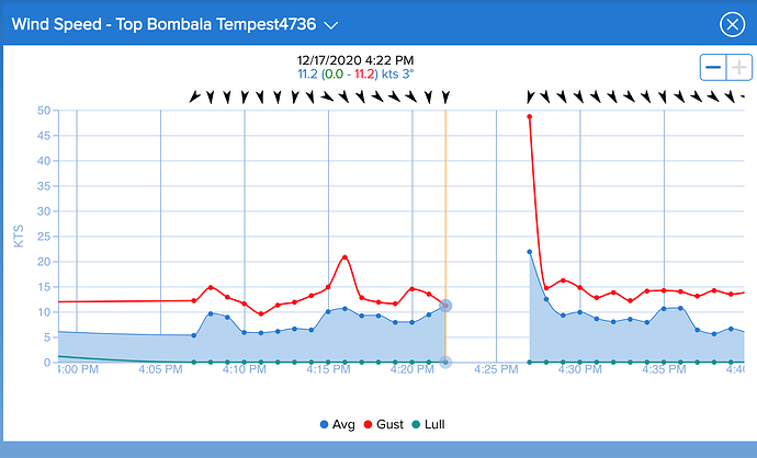

This is why I did not report this rain event…
Yesterday I had a power outage of less than a couple of hours during a strong thunderstorm that dropped 2" rain.
It took out my hubs and my internet during that period. From what I worked out the
power went off at 3:39pm and was restored at 5:15pm. So about 1hr 36min.
I have waited 24hrs for the data to backfill and it has not filled the entire gap in the rain records which I need to send in my report.
What I notice is that some sensor fields are filled while other sensors are empty and some filled a portion in the middle.
I have some Skys, an air and a Tempest.
The Tempest lightning records filled up.
but the tempest rain and all the other sensors did not (The rain continued extreme during the gap)
Screen Shot 2020-12-18 at 2.45.48 PM
But the wind on the Tempest filled some of the gap leaving a gap each side of the fill:
A Sky on a hub with nothing else connected only lost 11 minutes of records from all its sensors:
A hub with 3 skys and an air
all roughly lost 8 minutes of rain and wind
The air filled its temp and pressure ok but lost all lightning during the outage
Screen Shot 2020-12-18 at 3.11.53 PM
