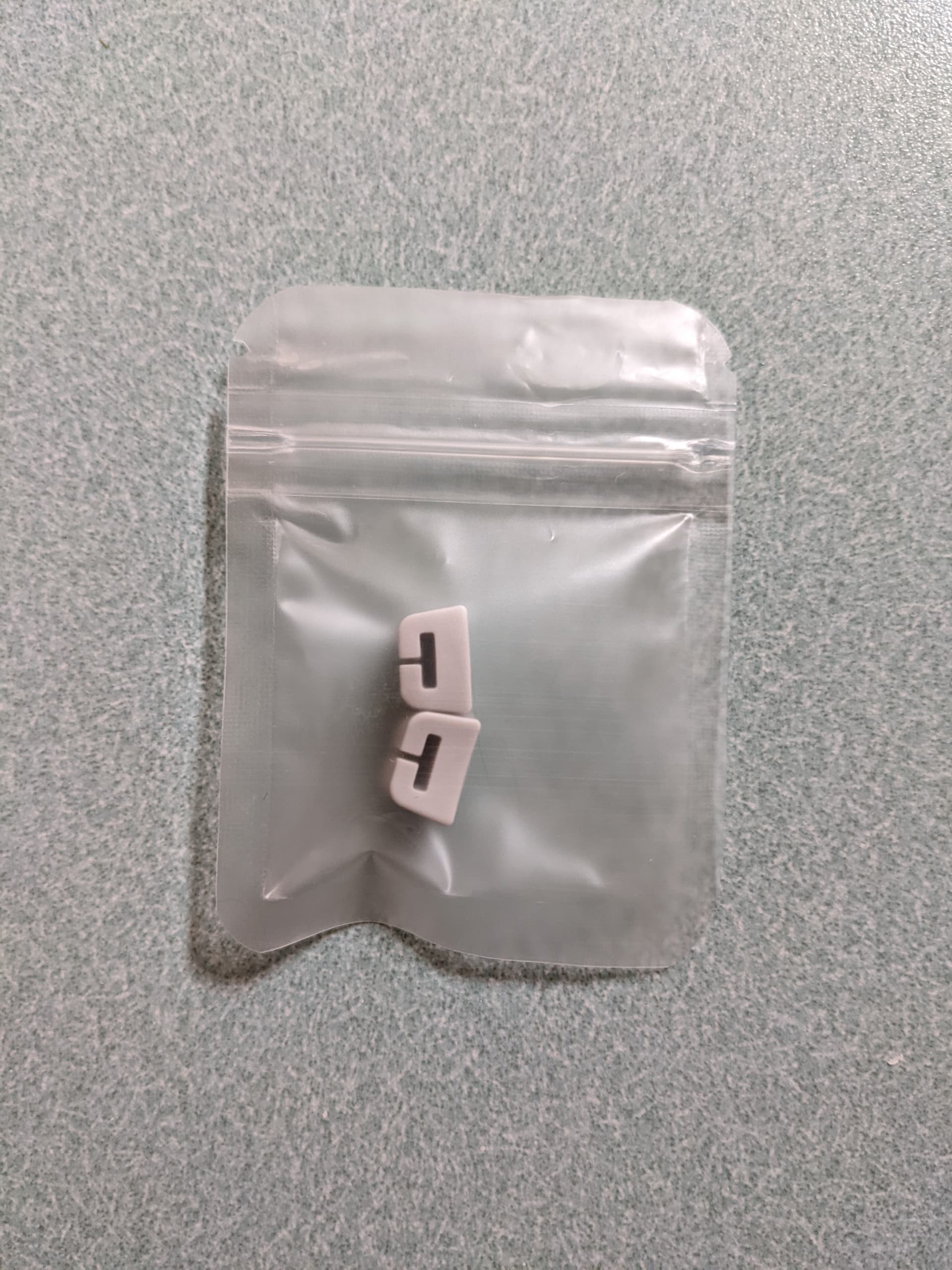

Okay, what are these things? I’m mystified. I assume some kind of wire management? I can’t figure out how they’re supposed to be used.

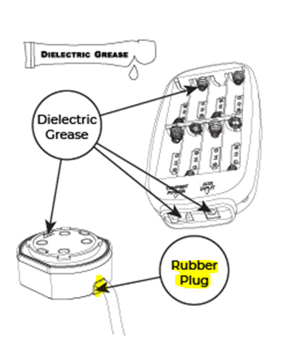

Included with the Power Booster is a rubber plug and a spare. Fit the plug over the flat cable and slide it into the wafer base. The plug only fits one way.
It will help keep moisture out while the Tempest device is locked onto the top portion of the “wafer.”
Thanks! This was not mentioned in the printed set of instructions I received with my power booster.
Yeah. . .I noticed that too immediately upon receiving mine last month. I had to “hunt” around for it. . .finally found it on the WF Power Booster Accessory page that tells about it.
I have forwarded this internally with the request to add the info in future prints. Not sure how many are still on stock but if we don’t ask … we don’t get :slight_smile:
