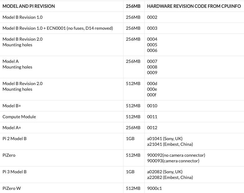

Take note of the revision number in the second last line and then refer to the table below.
Revision : a02082 → pi 3 model B made by sony UK
conclusion in my case : Pi 3B running strech
No need to put all the details like I did but for those who didn’t know how to find it … the long story :slight_smile:
