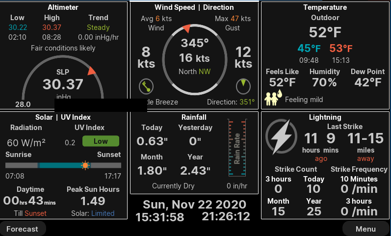

I am needing to display both Local (based on TZ) and UTC time in the Date/Time area. See example.
Original code:
Get current time in station time zone
Tz = pytz.timezone(Config['Station']['Timezone'])
Now = datetime.now(pytz.utc).astimezone(Tz)
I added:
NowUTC = datetime.now(pytz.utc)
If I use " Now = datetime.now(pytz.utc)" it displays UTC time correctly. Can someone point me to where I can add this to the display?
To ‘what’ display specifically ?
Sorry. The main screen, bottom middle.

Hi @bruce4, I’m not sure I follow exactly what you are asking here? From your screenshot it looks like you have already added another time to the display?

Sorry. I’ll be more specific. That was a cut & paste example of what I want it to do. Currently there is only one time field centered under the date on my display. Is there any documentation on this program besides the readme on Github? I hate to keep asking these simple questions. I also want to attempt to add Density Altitude to the display but that’s another topic.
Ahhh! That makes more sense. I was confused by the screenshot. Sorry! I’m afraid there is no documentation for modifying the code. I can point you in the right direction though - the layout code is contained in wfpiconsole.kv, and the clock and date are specified on lines 774-782. You will want to add another TimeDateField and tweak the x position and and size_hint_x fields so that it takes up half the available space.
