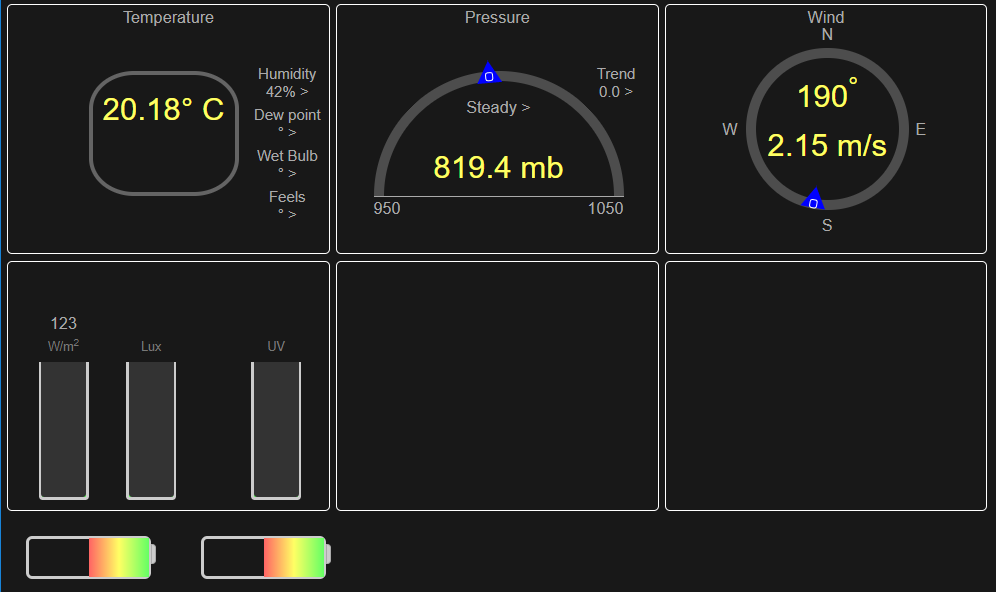

I want to share a new feather that I am working on.
It is designed to fit nicely on the RPi 7" touchscreen.
Edit: I posted a new image.
Capture
Make it fit on a cheap 1024x600 Android tablet (or run directly on it), and we’ll have a working $50 console for our WF stations…
It works great on my 7" Samsung tablet. I’ve had it running for five days and it stays connected. It even reconnects if I reboot the RPi
