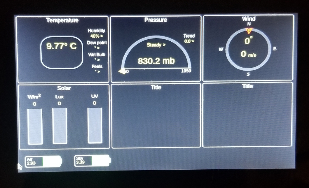

I posted a new image in the original message (scroll up 6 posts). Thank you to everyone that sent emails and and privates messages. After reading all of your comments I decided it will better to write everything myself.
As you can see in the image, I started over and I am happy to say that I wrote all the code from line one. It’s not very pretty but it’s functional and clean, It’s 100% JavaScript and all the work is done in the browser. This removes any stress on the RPi and you can scale this to a hundred devices with no issues.
I am currently running three phones, four tablets and seven computers all displaying the proper data. One of the best features is automatic reconnect should the network or RPi reboot. I have one tablet that has been running for five days and still going strong.
The demo is ready but there is still much work to do. I have not put any calculations or conversions in the code. Fortunately the formulas and converters are already written in JavaScript and I just have to add the JavaScript file to the RPi so it can send it to the browser.

This the the WFArchive Panel running RPi 7" touch screen. It’s still a work in progress but I’m pleased to see how nice it looks on the screen.

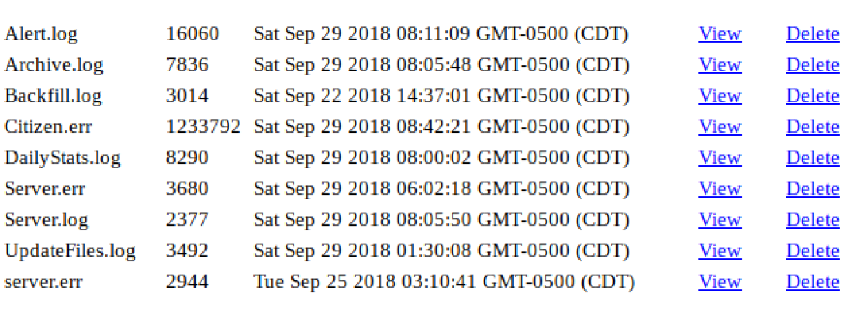

RPi been running all week and I see a few issues. Could be something on my RPi however I thought you want to know. I have not updated all week, will go do that now. In the meantime have a look. Let me know if you have questions or suggestions. Thanks.
The Citizen.err file was over 120 meg in size. I deleted it and let it do its thing. Looks to be 1 exception happening often and growing quickly.
TypeError: Cannot read property ā€˜on’ of undefined
at Object. (/home/pi/WFArchive/wfarchive/cwop.js:74:5)
at Module._compile (module.js:653:30)
at Object.Module._extensions…js (module.js:664:10)
at Module.load (module.js:566:32)
at tryModuleLoad (module.js:506:12)
at Function.Module._load (module.js:498:3)
at Object. (/usr/lib/node_modules/pm2/lib/ProcessContainerFork.js:75:21)
Also noticed there are 2 Server error files. Server.err and server.err.
In ā€œserver.errā€ is one exception that repeats
Error: Connection lost: The server closed the connection.
at Protocol.end (/home/pi/WFArchive/wfarchive/node_modules/mysql/lib/protocol/Protocol.js:112:13)
at Socket. (/home/pi/WFArchive/wfarchive/node_modules/mysql/lib/Connection.js:97:28)
at Socket. (/home/pi/WFArchive/wfarchive/node_modules/mysql/lib/Connection.js:502:10)
at emitNone (events.js:111:20)
at Socket.emit (events.js:208:7)
at endReadableNT (_stream_readable.js:1064:12)
at args.(anonymous function) (/usr/lib/node_modules/pm2/node_modules/event-loop-inspector/index.js:138:29)
at _combinedTickCallback (internal/process/next_tick.js:139:11)
at process._tickDomainCallback (internal/process/next_tick.js:219:9)
In ā€œServer.errā€ - Looks to be the same error

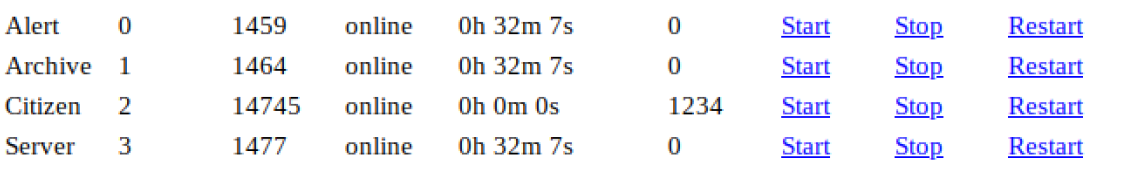

After you update you will need to restart the scripts marked as a service. You do this on the Process Management tab.
Roger that, I did do that. Let me do it again just to make sure.
Ok, did it. Do not see any server error logs, but Citizen is not happy.

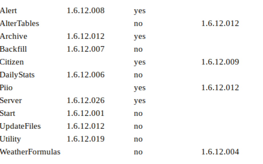

When I look at the Versions Tab seems like the same versions as before.
Something is not correct. Citizen did not start.
Its running, I did stop and restart it to make sure.
Do all the versions look correct?
Well, there is an issue. PM the cwop section of your Config screen, please.
