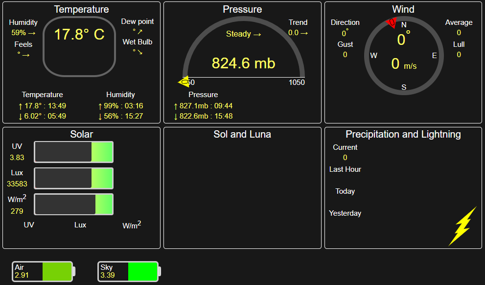

I made a lot of changes to a lot of files. If you update the files, please restart Server then go into Config. You will see there are changes and a new field named âBroadcast IP.â The is the broadcast IP on your network. Normally this is the last address of your IP range. X.X.X.255. Please set this and click OK.
Now you can restart the rest of the processes.
Archive will broadcast information that the other processes need. The Panel will send data to data to Archive requesting data it needs. Alert and Piio will listen to Archive and act on data received. ]
All-in-all the scripts are using UDP to communicate with each other. In the future I will most likely change to TCP but this let me get started quickly.
The Panel is designed for the Raspberry Pi 7" touchscreen and it also works well on small tablets such as the Amazon 7" Fire units. I have been running one for several days and have not had any issue with it losing the connection.
