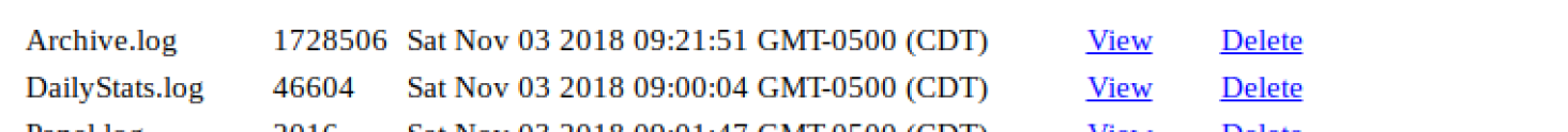

  3. Have you considered limiting the log file size or archiving a log at a certain size ? Sometimes I do not look at the logs for a few weeks and some of the log files can get very large. The Archive Log is big but I have seen larger when the RPi had a hiccup and a file has grown to many megs in size.
