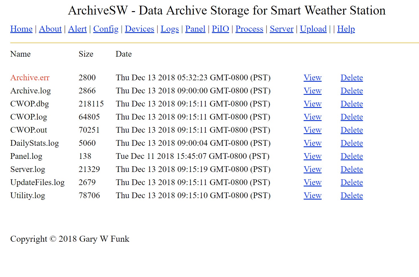

Looks like it downloaded but it doesn’t seem to be uploading after about 15 minutes. I don’t see anything in the logs and the process doesn’t seem to be running. See the screenshots below…
Did you set it up on the Upload tab?
Yeah, I did.
Server was updated. You need to restart the Process.
Seems to work now. Thanks!!
