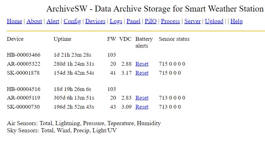

I am adding the sensor status to the Devices page so you will see some new files tonight. The base code is in place but I have a lot more work to do on the Devices page. The data is there in order but it’s non-descriptive.
The Devices tab will now show you sensor failures for Today.

ok, and how do we read the sensor status, I have other numbers then you …??
yours start with 7, mine with 1 …
44
See the legend at the bottom?
Air Sensors: Total, Lightning, Pressure, Teperature, Humidity
Sky Sensors: Total, Wind, Precip, Light/UV
Air has five numbers, Sky has four.
Your device SK-00007807 is defective. .
I saw the legend but I still can’t ‘translate’ the numbers
what do the numbers means ? They change all the time
regarding sky 7807 : guess it is related to low voltage and several sensors have gone silent to preserve batteries
05
The numbers, 580 580 0 0 are Total sensor readings, total wind failures, total precip failures, total light/uv failures.
The first number in the set is the number of sensor readings for the day. The remaining numbers are the number of failure readings.
Your Sky has had a complete wind sensor failure.
now I understand, yep wind isn’t recorded, but once I install fresh batteries or who knows a solar panel, it’ll come up again.
