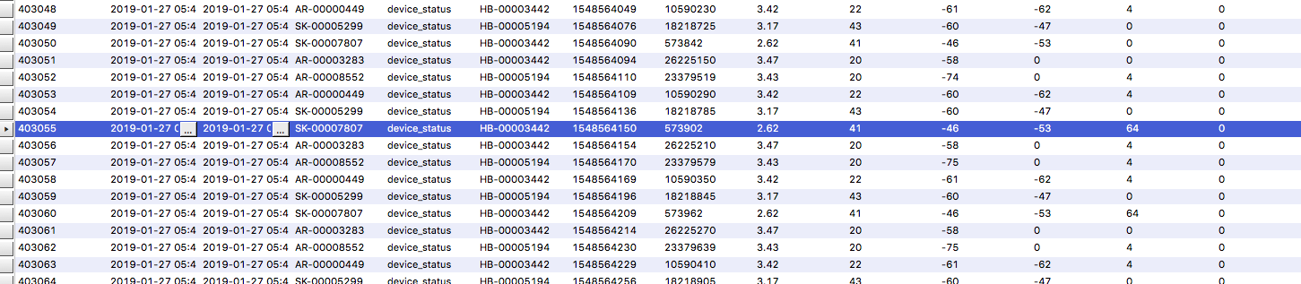

You can look in DailySensor to find the day it started then look in DeviceStatus to find the first failure and the voltage will be there.
there you go
Excellent. So somewhere between 2.629 and 2.620 it failed. Iām guessing an urgent warning at 2.65 would be final. I believe David has mentioned 2.7 as a cutoff.
isnāt it linked to the values we give in config tab ?? (they are default 2.4 and 2.1)
Also since latest change of the device tab, it sometimes times out
Those values are for internal alerts. For your Sky it should be set to 2.7.
Just a thought, I have the Australian frequency version, so there might be a difference in their power demand?

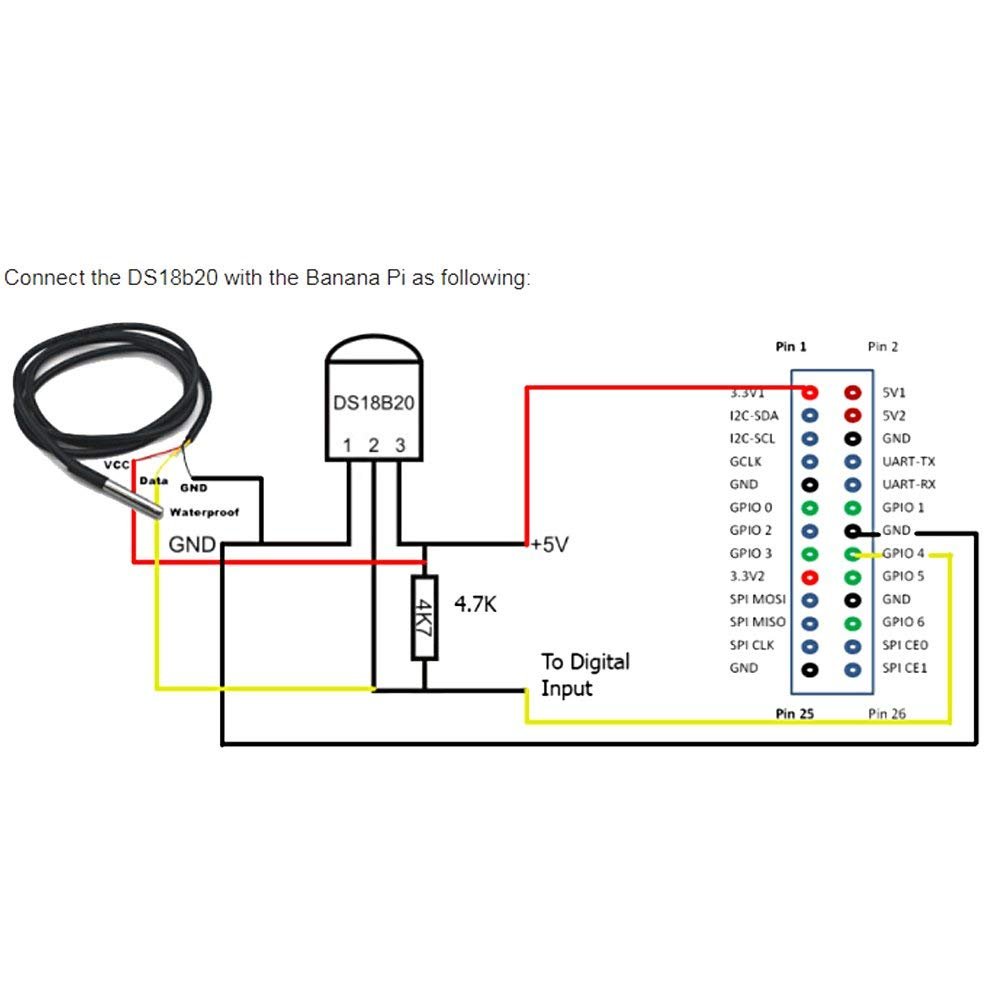

For hooking up a DS18B20 temperature sensor to the RPi, is this the correct diagram to follow?
Any thing else to do on the RPi so that ArchiveSW will see the sensor?
Yes. A trusty Fluke 287. The display uses 0.47 ADC at startup then drops to 0.1919 ADC at stable.
Are you using the 26 pin bus or the 40 pin bus?
Good question. I didnāt thinik of that. RPi 3B+ so 40 pin.
You want to use pins physical pins 1, 7 and 9.
1 is 3vdc, 7 is gpio 4 and 9 is ground.
The resister goes between 1 and 7.

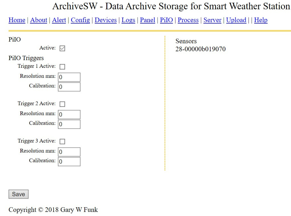

After seeing that my temperature sensitive plug isnāt turning on the heater in my RV soon enough I thought of using the RPi with temp sensor to program a relay to do it. In reading the documentation on the ArchiveSW web page it says, āpiio.js - Accept inputs for three closed contact switches and has five LED outputs for instant status.ā I assume this is the page where I could setup outputs?
Or are the PiIO triggers listed for the input switches? I would like to have either an on temperature and an off temperature or an on temperature and a hysteresis value. Is this possible to do with ArchiveSW right now?
