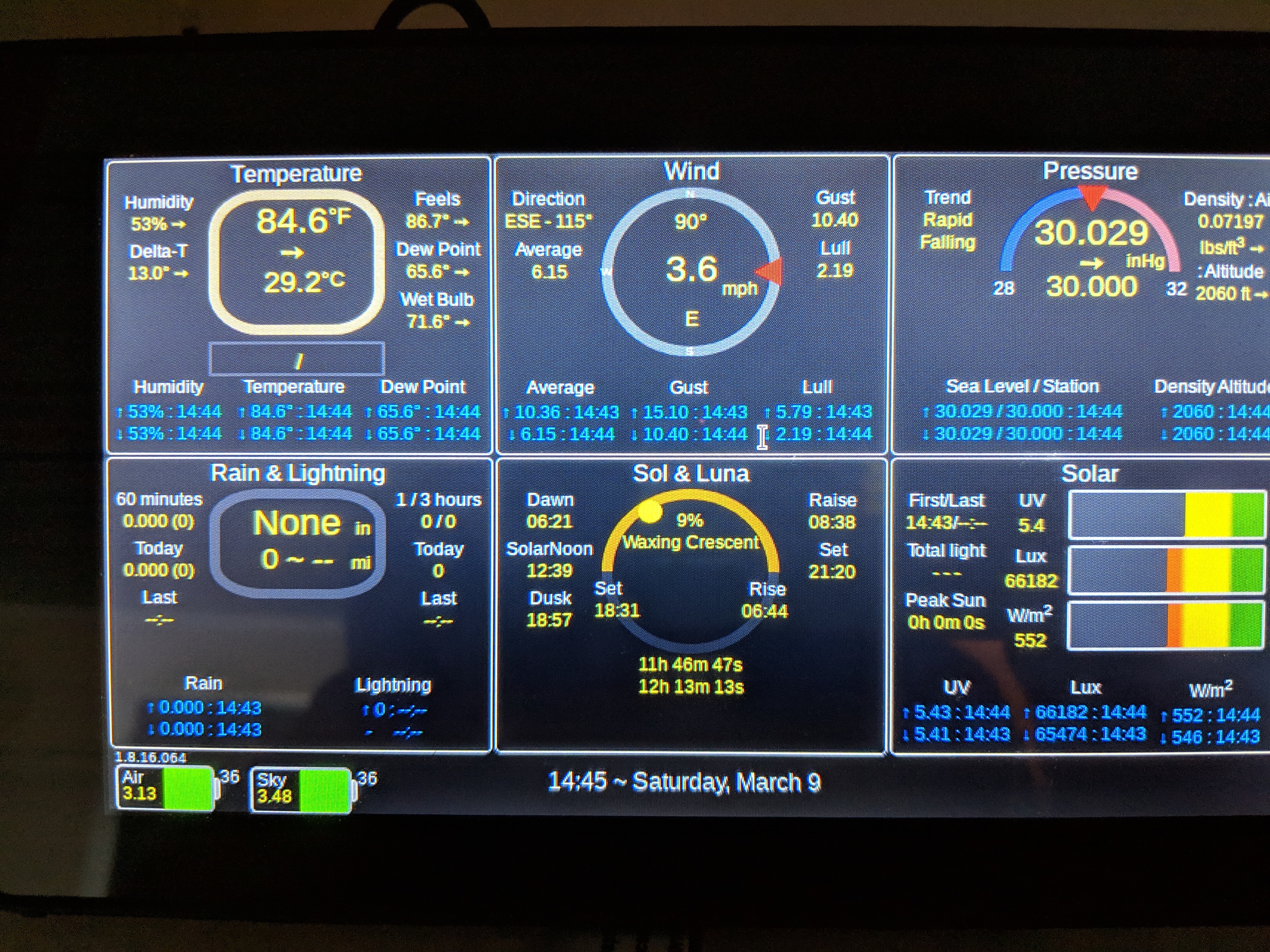

Reinstalled over my old install and everything went fine and it is now working correctly. Thanks @GaryFunk for all of your hard work!
screen
It looks good. I’m pleased to know you have it working.
