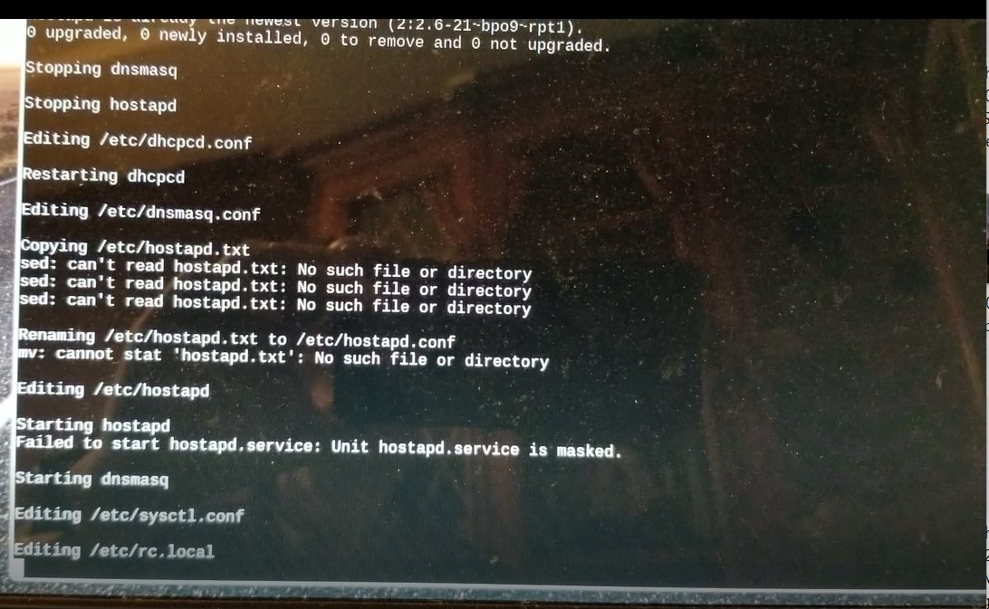

On a fresh NOOBS install, I let it update during final setup then ran the accesspoint.sh script and let it run the update script. It rebooted again so I re-ran the script and videoed the screen to get past the VNC delay and this is the frame just before the terminal window closed and the RPi rebooted.
Crash%20and%20reboot%20screen%20on%20AP%20setup
CRAP!!!
You are running an old script. I need to fix that.
Use this one.
bash -e <(wget -qO - http://fsoft.com/archivesw/script/accesspoint.sh)
