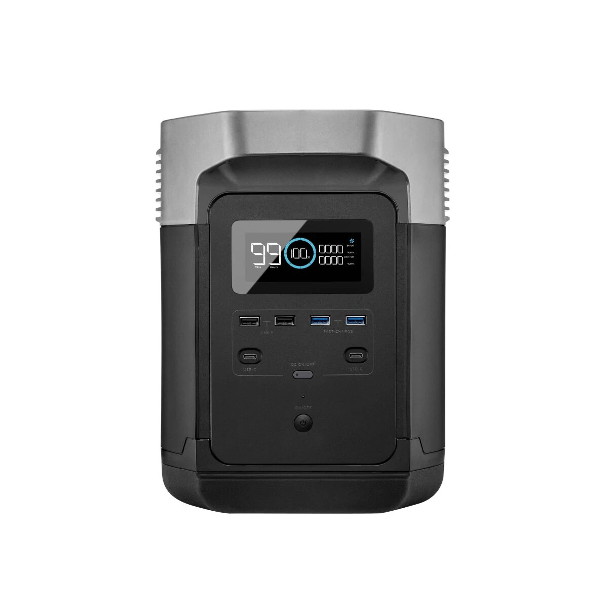

I have this sitting waiting for a power outage. I have a UPS on the network stack including the weatherflow hub and then if the power goes out it takes about 30 milliseconds for the battery pack to swtich over so the UPS handles the load until the battery kicks in. Costco had a deal with them last year and got one for myself and one for my mom’s house.
