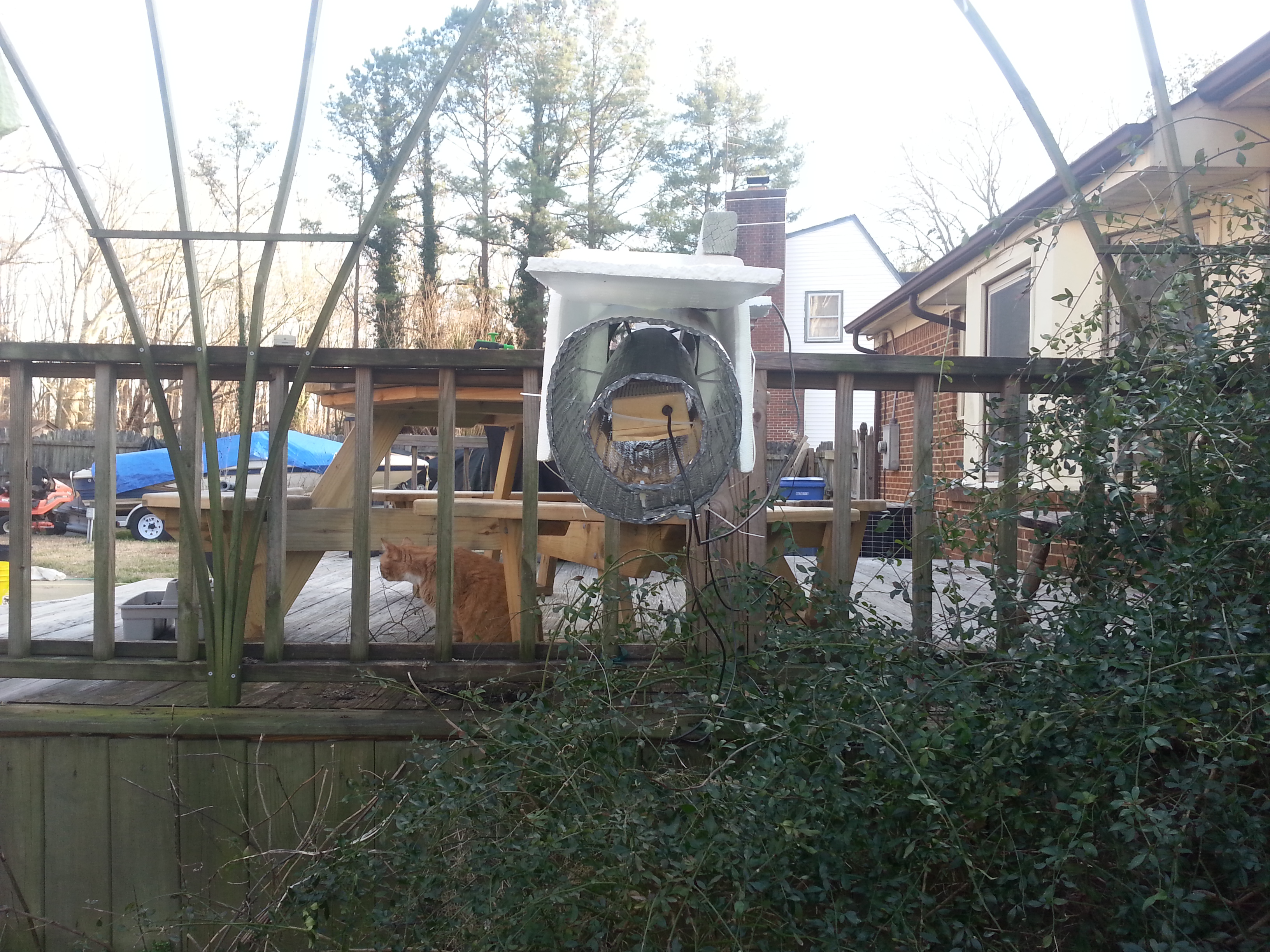

20150208_164525
This is a ventilated shelter I made a few years ago. Two foil lined bubblewrap tubes,cpu fan
pulling air through both. Air pulled past sensor is not affected by any amount of solar radiation
at all. Also not effected by radiational cooling at night. Air mounted out in the open can read low, (Temp 38f , frost on ground-car tops). Did not use this for my air, due to foil might effect radio trans and receive. My air is in a new design using styrofoam and corrugated poly. I will get pic and post.
Very cool design! Love the things that weather enthusiasts come up with to solve a problem.
Now that’s a great explanation. Thank you for taking the time to post the photo and explain what you did.
@vreihen I take it that the idea is to draw a slow constant stream of ambient air across the device in lieu of placing it in an area where it will receive natural air flow. Is this correct? Is this the purpose of the Acu-Rite device fan?
In low wind conditions, no matter where the location is, there is not enough air flow to carry away radiated heat within the shield. This is a very common problem in small shields that are used in a home system. A fan maintains the air flow bringing in ambient air.
