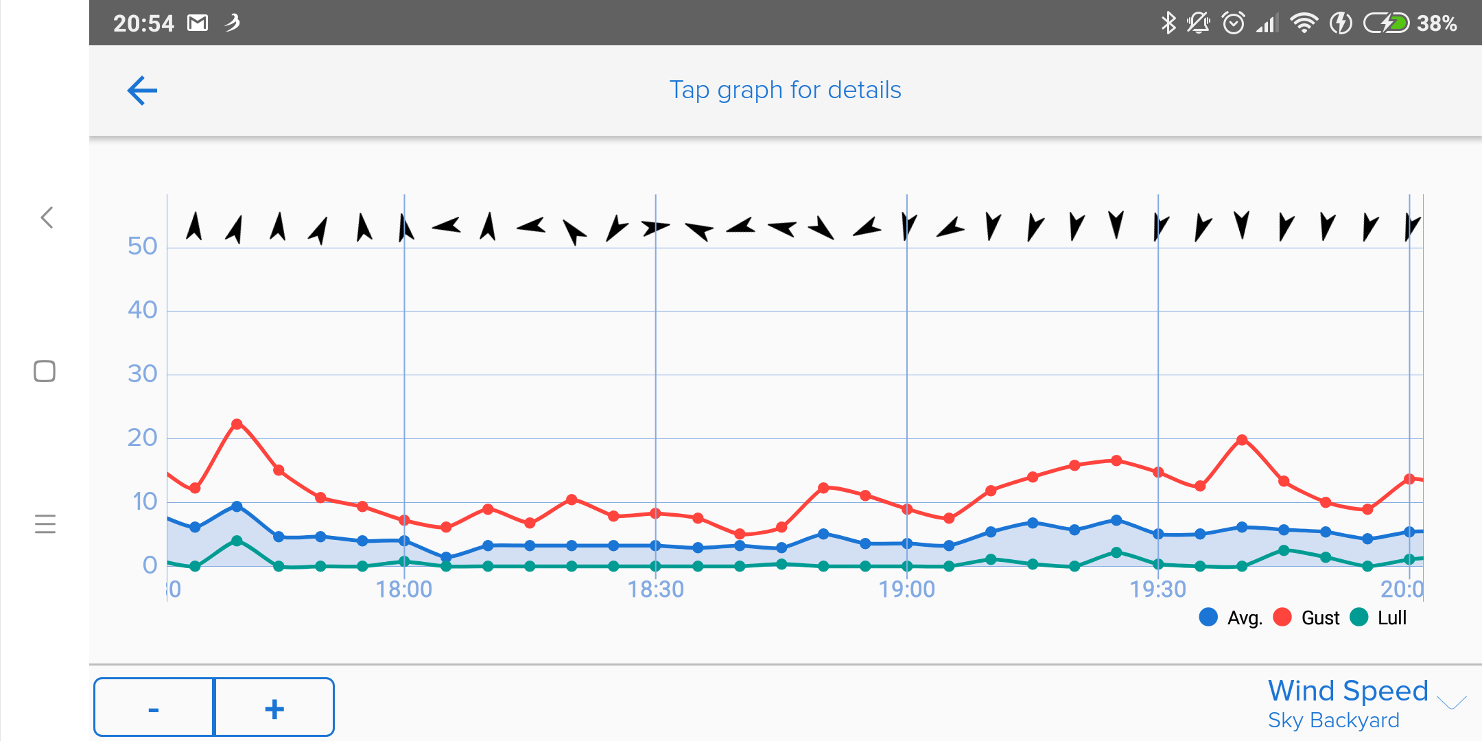

Here is a nice example of a windshift after back bend occlusion past trough.
This has nothing to do with rain on the sensors, but wind going from SSW to NNE after the rain.
The wind was calming down in the rain and then picked up again from the other direction.
Nice to notice it in the windgraph.

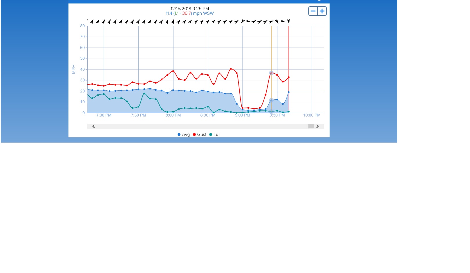

After reading about a new release of some version impacting Sky’s wind sensitivity, I wanted to share several problems in Sky reports occurring today. Wind gusts did not exceed 16mph but Sky reported gusts of: 75.6mph, 69mph, 50mph during this period. While we did have light rain during the errant reporting period - the gusts were inaccurate and have to be considered erroneous.
Problems began at 5am, December 15, 2018 Any ideas why this now occurring when gust reporting was fine until this morning???

The AcuRite 6" away from it 25’ up only recorded 16 while the closest weather system north of me had a 20mph gust and the nearest south of me also recorded 16mph.
Okay. However, the AcuRite uses cups which are not able to measure very short bursts of wind. The Sky is extremely sensitive to the shortest burst of wind.
Please review! I’ve evaluated sites north and south of Sky and the profile in this
snapshot simply is not possible. The wind profile could only fit if a tropical system were passing overhead with a nearly calm eye - this is not the weather pattern here.
Simply, something is going on here that can’t be explained. Winds for surrounding stations are
consistently between 9-12mph. For those thinking there was a meteorological reason for gusts over 40 at 8:50pm - there was no change in pressure during the spikes in wind gust to near calm wind a few minutes later only to bounce back to gusts near gale force.
Still need something done to restore my confidence in Sky.

The attached image demonstrates a major problem with my wind readings. The weather in surrounding stations are experiencing wind gusts under 20mph for this period, in fact, my AcuRite
and another station very nearby both recorded 16mph for the day. I am 100% sure we didn’t have hurricane force gusts throughout the day.
Please tell me why my Sky is malfunctioning? It began malfunctioning around the time I was reading a new version was being released. Can someone with the means return my Sky back to a reliable, consistent system?

Hi @gliska15,
That looks like water droplets on the reflective plate. As soon as I saw your graph I suspected rain droplets due to the sudden change in direction combined with the high gusts. Here is the discussion Can Rain Affect Wind Readings - Looks like Frost can as well (Updated) - #7 by dsj

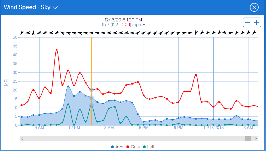

I had a similar thing yesterday. It was raining all day and
around 10 am and sky said I had a gust of 42 mph. For the next several hours the sky was showing winds mostly between 20 - 30 mph. My Davis which is about 10 ft. away and 2 ft. higher never went above 10 mph. Visual observation of the trees moving backed the data from the Davis.
Then the sky must have dried (even though still raining) and was back in relative sync with the Davis since.
I’ve added graphs of the same time of WF and Davis.
