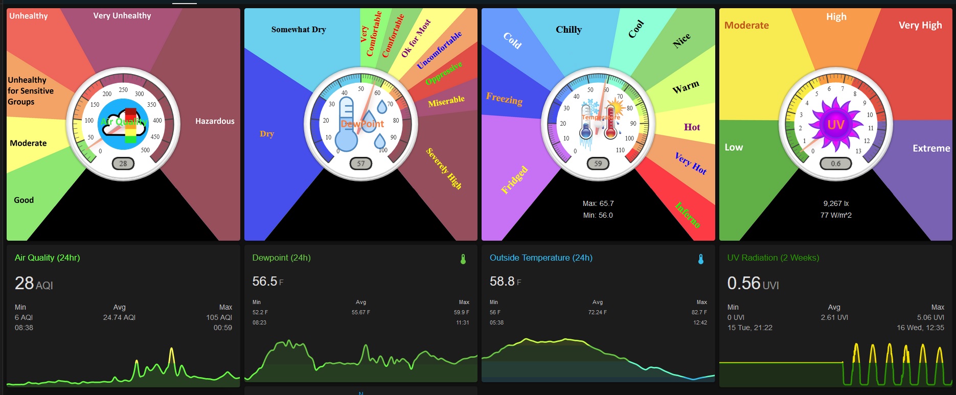

@btst.online
Here are some little enhancements you could do. The Air Quaility is the only one not from my weather station.
I rotate the compass needle when the bearing changes.
For that page, the code is all HTML/Javascript (which you can see by right-clicking and ‘view source’).
As far as the humidity… 100% is more accurate, as TS Claudette passed through this weekend, and now we are getting residual popup storms coming off the Gulf.
