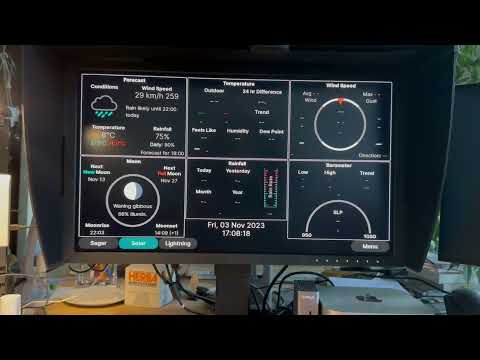

linked it to my 27 screen (had to take it of my mac)
and a little video
This looks like progress? I take it you no are longer getting the X window error on the 27 inch screen?
The blank screen looks like you are using the demo config file? If so, I think I know why it is crashing when you press the menu button.
I have that on the touch screen too and no this is not the demo ini file but a filled one
Ok, so the console starts on both screens, but you don’t see any fields populated?
yep, that’s it, I don’t have the hdmi linked anymore, need it on this mac :slight_smile:
And the console is blank when it is configured to use either UDP or Websocket?
Can you send me a copy of the ini file?
