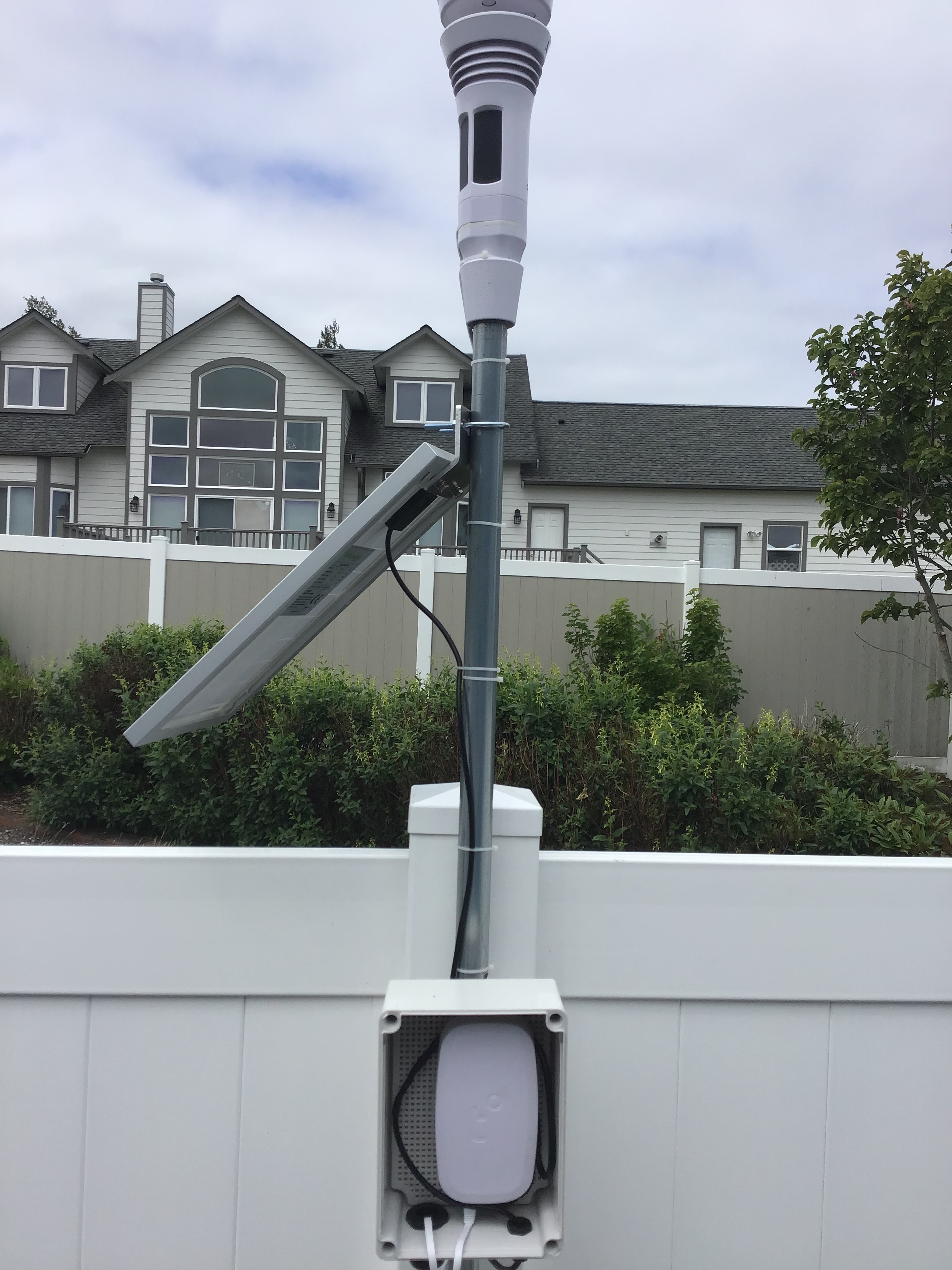

I just pieced together a small setup for my Tempest a few weeks ago and have been meaning to get it posted to possibly help others, so here goes.
Used the power booster accessory, a 5w 12v solar panel, barrel adapter for the solar panel/pba, enclosed junction box/nema enclosure, solar panel mount, pole mount brackets for the solar panel mount, and a cable nipple/pass-through for the box.

Pieced all of this together in a nice little setup, the panel connected to the pba provides enough power for a rapid charge to full with even short blip of light (think mostly cloudy with an occasional break in the clouds), provides a slow charge during overcast but small amount of light coming through, and in full overcast it provides just enough power to maintain voltage during the day without losing any charge (still going to drop overnight).
completed setup:
the forum will only allow me to post one image currently… so there is the completed setup.
the only change that I would make if I was repeating the project is to get a slightly larger enclosure, the one used works but it is a little bit of a tight fit getting the rj45 and the barrel plugged but not bad. A larger enclosure would also allow for a small battery and charge controller if you wanted to go that route.
forum would only let me post one image, so here is a second showing how I situated everything in the enclosure. Added some lithium batteries to the pba that charge the tempest in the event the panel isn’t putting out power and the tempest voltage drops below 2.42v.
