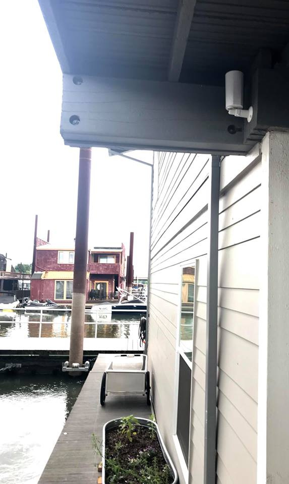

it needs an area where heat will not build up. So normal free air flow. I mounted the Air at a back inside corner where it will never get sun and two feet away from the house so no reflected heat.

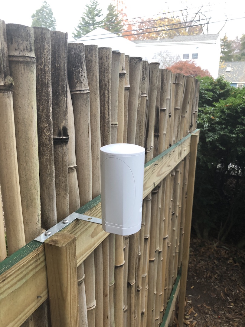

Mine is located in shade on the back of a small bamboo fence.
IMG_1376
nice installation but I think the sunlight will hit the AIR on the summer, because of the sun angle, it turn more to the north on the summer and become more vertical on the house. so i think this will not protect the AIR from the sunlight.

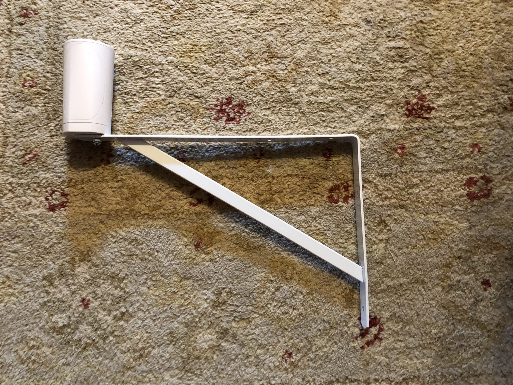

Finally had a weekend day when the temperature was (barely!) above freezing and not snowing. Off to the big-box home improvement store, to pick up some mounting hardware:
1 x heavy duty 16" x 10" shelf bracket:
https://www.homedepot.com/p/Everbilt-16-in-x-10-in-White-Heavy-Duty-Shelf-Bracket-14826/202895664

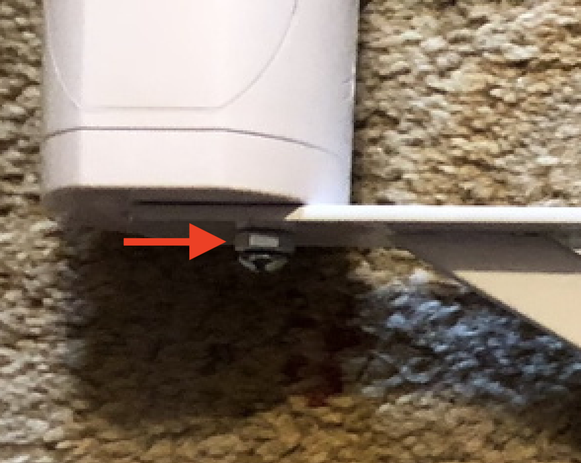

1 x 1/4-20 stainless screw, 5/8" long (camera tripod size/thread)
1 x 1/4-20 stainless nut
2 x 1/4 x 1.25" stainless sheet metal screws
The results:
20180408193703-2df99fa8-xx
The nut is being used as a jamb nut slash spacer under the screw head:

The bracket is now mounted to the north wall of my detached/unheated garage, where my other Air has been performing acceptably without a solar radiation shield. Let’s see if this fixes the almost daily false lightning strike alerts…

How far away from the wall is your Air? This setup sets the Air at 15-16" off of the wall, which is far enough to clear the roof overhang. My other Air has been hanging horizontally from a screw in the same wall for a while now, and has shown no evidence of thermal influence from inside the unheated/detached garage.
If I get any more false lightning strikes with this Air mounted out there in no-man’s land, I’m definitely going to sink a ground rod and connect the bracket to terra firma just to see what that does…
