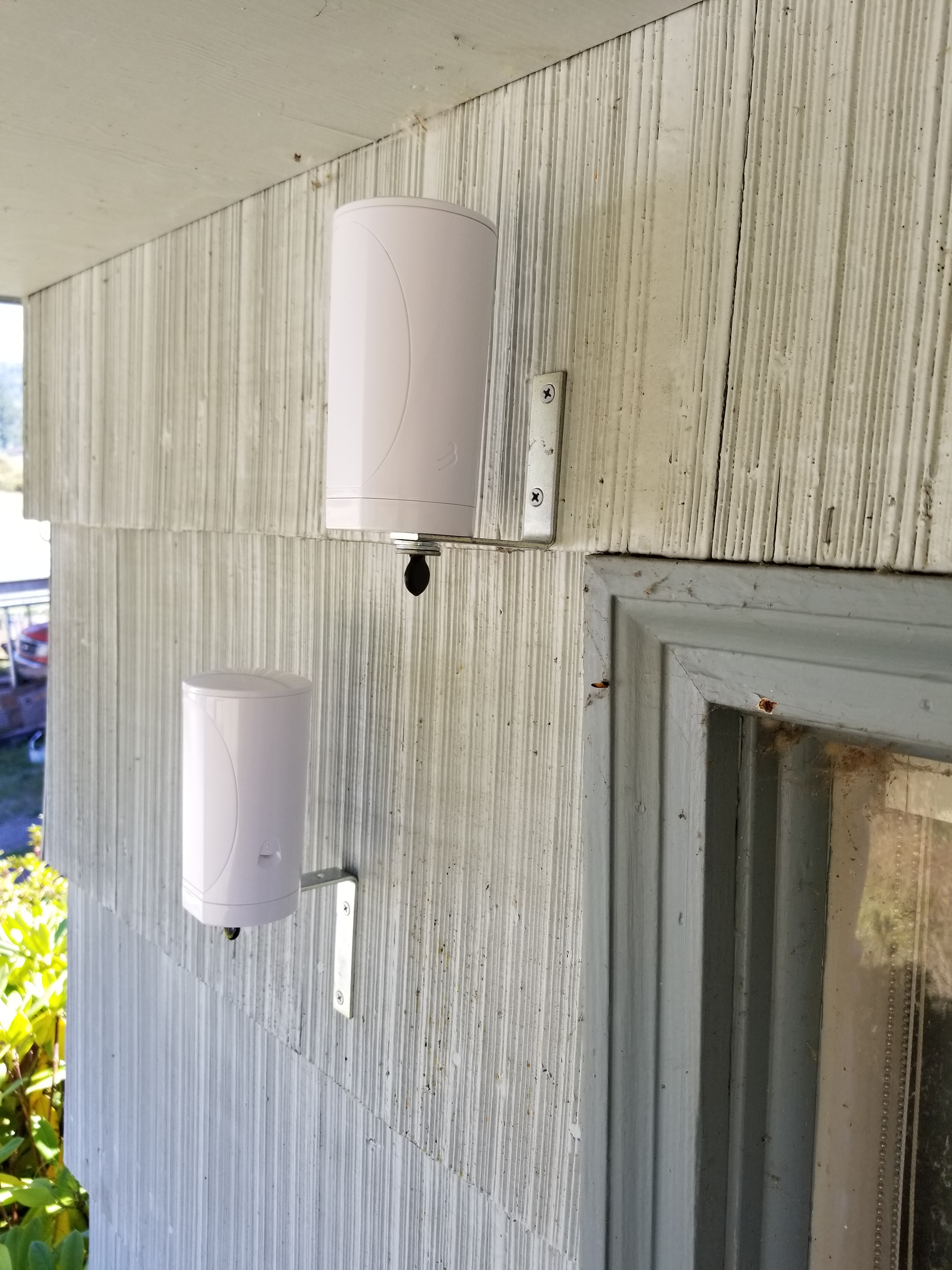

I mounted my permanent and mobile AIR units to my front porch. I initially had the sensor hole mounted facing away from the house but kept getting false lightning messages so I now have them facing opposite directions at 90 degrees to the house. I mounted them at different heights to see if the one higher and closer to the single pane glass window tends to read a higher temperature than the other. I’ll have to wait until next summer to determine if the sun will hit either one as it shines over the mountain in the mornings. The thumb screw will allow me to easily remove one when I go camping or to swap places to verify differences in temperature readings. Hopefully I can find the materials to build a Stevenson screen like @ruud did. That looks great!
20180902_133643
I see you have them 180 degrees facing. I will be interested to learn from you if one detects lightning the other does not.
I’m curious too, that is why I faced them opposite directions. We don’t get much lightning here so it might be a while. At least right now, since I faced them opposite directions at about 1:00pm today, there have been no more false alerts.

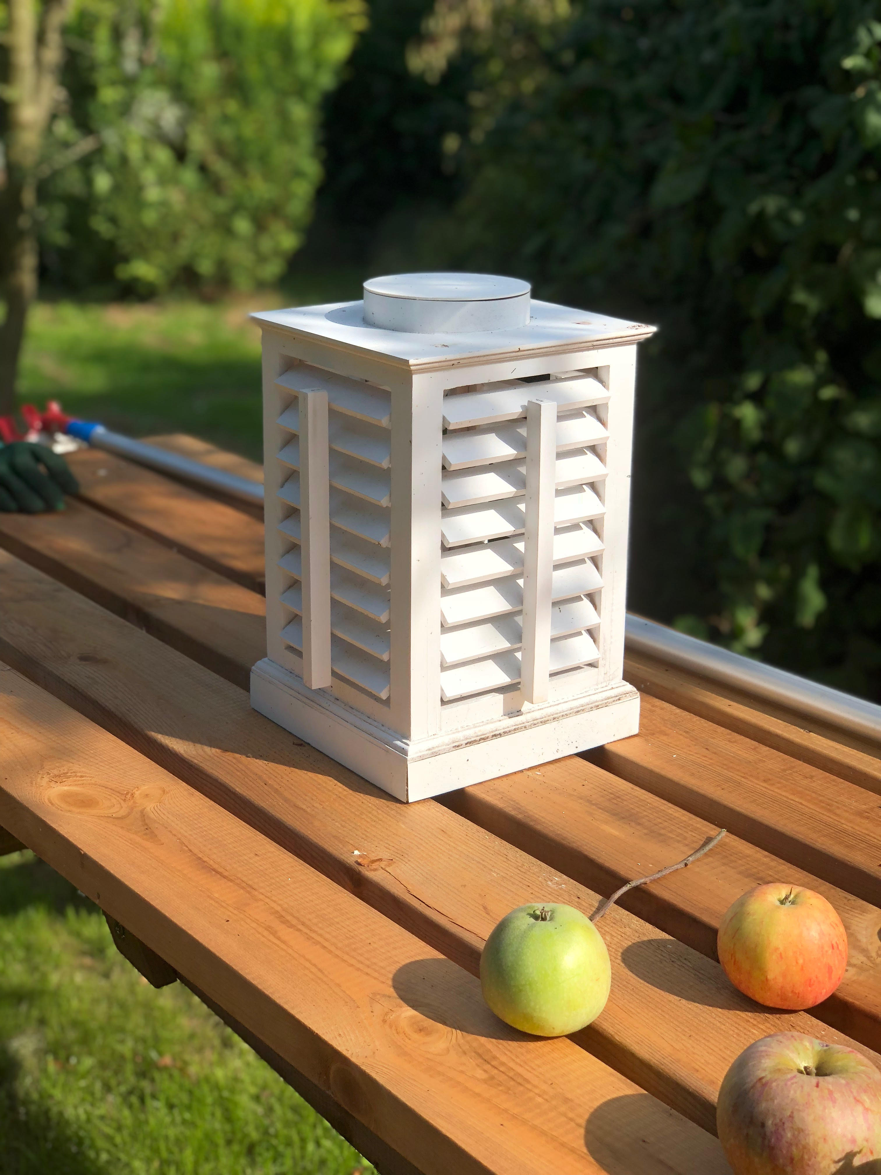

I have been pondering a Stevenson Screen for while but have been put off by the cost - as such i came across an offer on an LED Candle and Holder in Dobbies in the UK (a garden centre). Its made of wood and has slants at 45 degrees. I thought it was worth a try at £14.
SScreen
I 3D printed a top to stop the rain getting in, although i guess it limits air flow and could be modified.

Now that’s a stylish Stevenson screen, congrats!
Do you have a web link you can share?
It’s not on the online sttore I’ve looked it up https://www.dobbies.com/ These things cost 39,95 EU here online but I saw no measures
