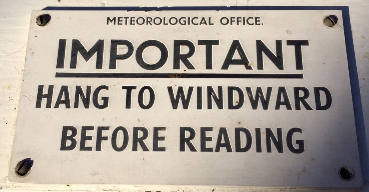

I thought you might be interested that your Stevenson screen is very similar to the authentic, vintage UK Met Office one I have restored and deployed and which appears to do a good job.
Pics attached.
UNADJUSTEDNONRAW_thumb_2101 UNADJUSTEDNONRAW_thumb_2102 DkcHDSNRTzmT00CKHgd%20lg_thumb_2103

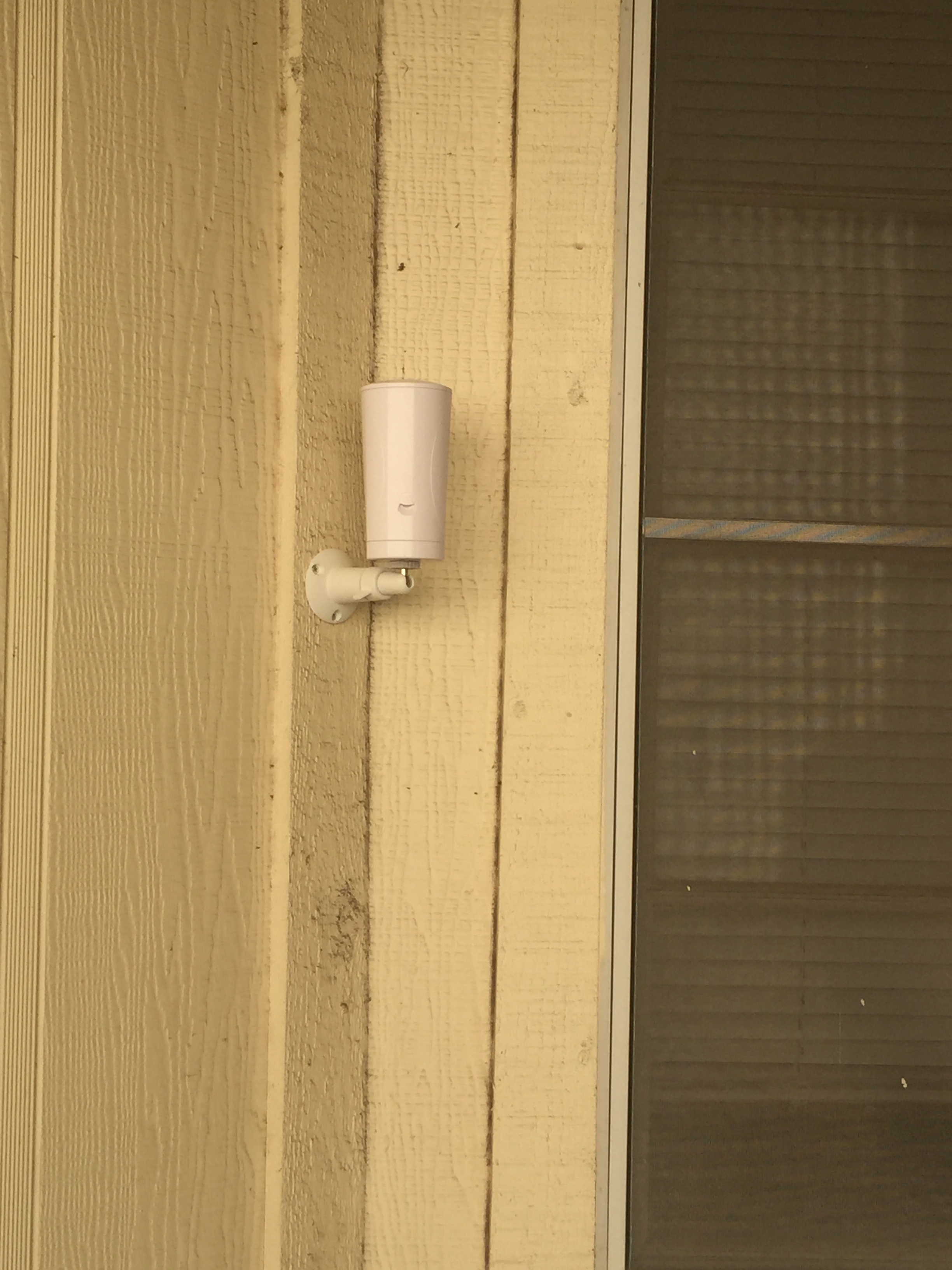

I finally have mine on a mount on my front porch.0FA3E98F-062D-43F3-A161-693B57A0403B IMG_2580
