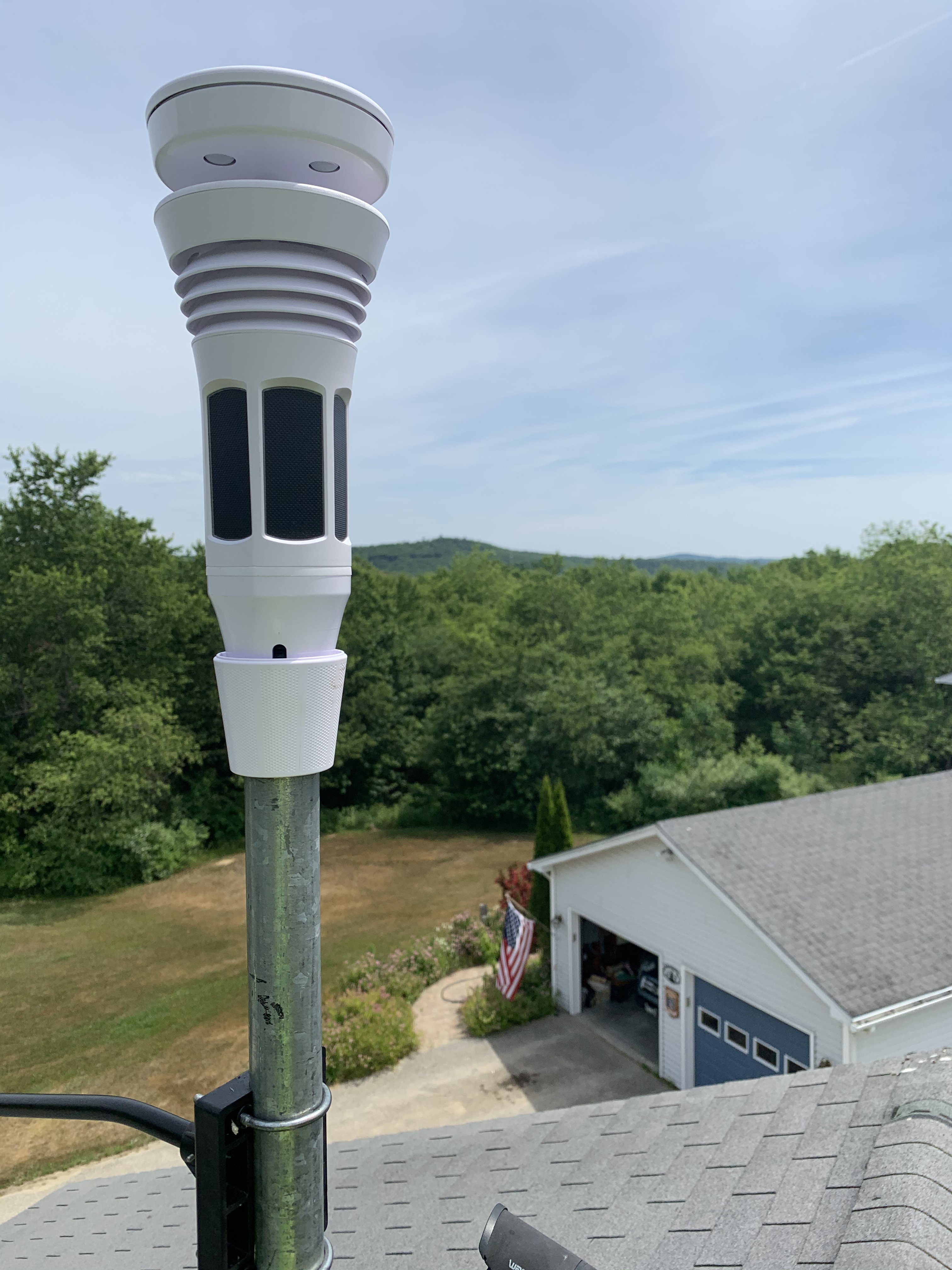

I got mine all setup on Saturday, can only get it about 9’ off the ground in the back yard. So far after two days the data is coming in great and actually picked up some lightning.

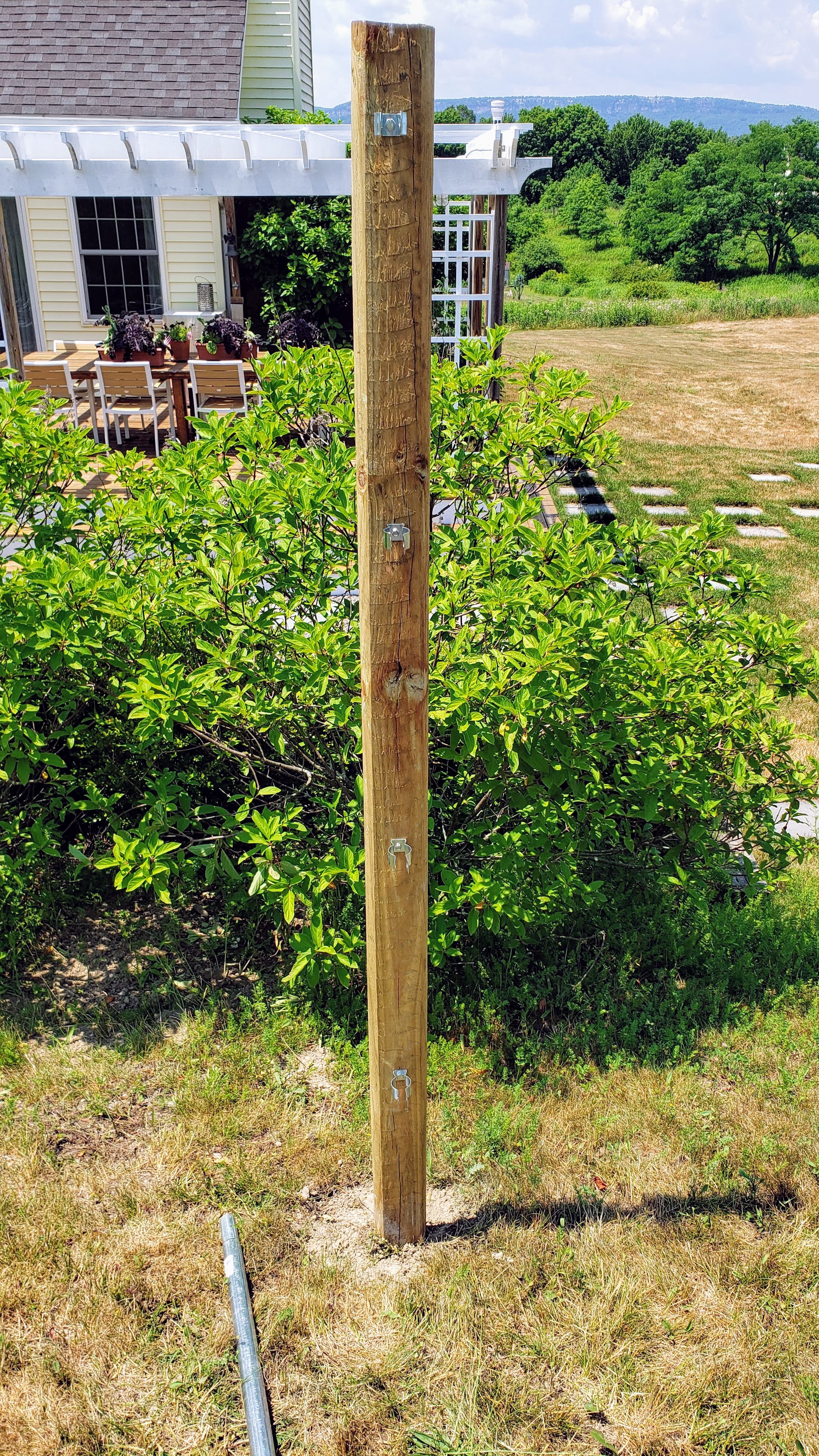

Decided to move it off the deck post (too many false rain vibrations) and installed it using the 10.5’ fence top rail attached to a 3x4 landscape post. The post is about 2’ in the ground with a bag of quick set concrete poured in. The top rail is attached using #2 conduit clamps. All of this was purchased at Lowe’s for less than $30.
Everything is nice and plumb…here’s a few pics of the installation…pay no attention to my mostly dead grass, it was a dry June in eastern NY!
