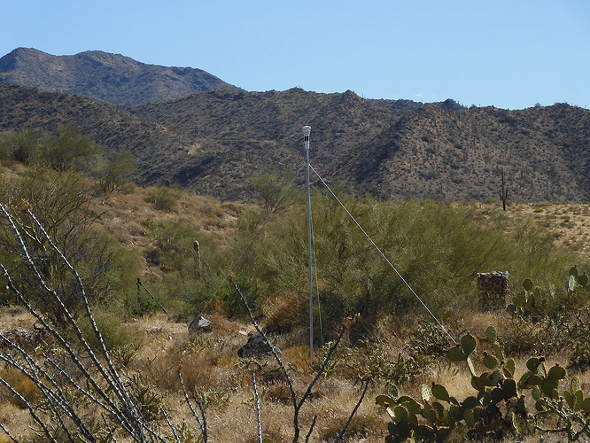

And finally installed at its permanent location on a 10-ft pole from a fence top rail. Notched the bottom end to keep it from rotating to keep North aimed at North, whalah! Someday it will have a permanent data link.
