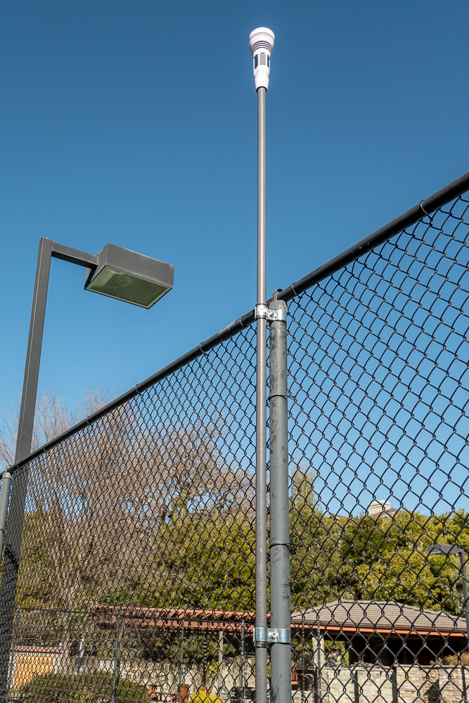

Mounted on schedule 80 PVC pipe clamped to tennis court fence post with double pipe clamps. Wrapped pole with rubber to dampen high-frequency vibrations caused by balls hitting the fence.
I previously considered mounting it above the roof of my house, but I decided against it. The roofing is black cement tiles with a thermal barrier underneath, which radiate a lot of heat on sunny days and would affect temperature readings.
Don’t be surprised if wind causes false rain readings. Hopefully the rubber dampers can block it enough. A ball hit is relatively short lived so the Tempest may be filtering it out based on that but the longer term wind induced frequencies may not be filtered out.
