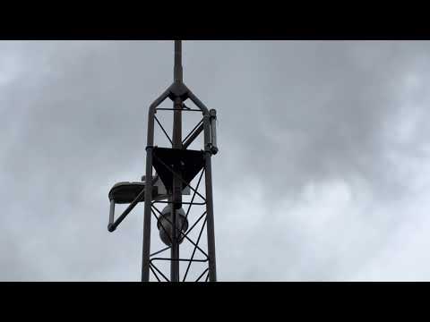

[My install](Photos of Tempest Installations :tempest: - #989 by ding.b
No rain/snow today and just the strong breeze associated with storm Arwen and it’s been falsely recording all day. I’ve shot a movie of it and it is visibly quivering in the gusts about 20+mph
Can only think of sand now or/and another clamp!!!
My wooden poles vibrate slower than that and don’t cause false rain readings. Maybe sand would work, but if you can lower the vibration frequency it would take care of it, too.

I have now wedged 2 pieces of wood between the pole and chimney.
If this successfully stops the movement at the top, I was planning on getting some rubber blocks to replace the wood or even better drill 2 more clamps off the brickwork.
Failing that my only other choice is to lower it to slightly above the opening of the chimney but that will mean it’ll be near the roofline which I was trying to avoid.
I’ll be wedging these bad boys in to take the place of the wood soon (if the weather goes mild), Blocks of rubber is very expensive so got these from a large online retailer I won’t mention but is akin to a place in S.America for a few quid (pounds sterling) each. I think the wood is doing a good enough job stopping wobbling along the length of the poles. Not pretty but quite frankly IDGAD

Add more pipe. Get it at least 10’ higher. Let it sway. If it’s too stiff it’s gonna vibrate and that’s what sets off the rain sensor.

Rubber in place now (whatever the outcome, it’ll be interesting to see what storm Barra gives!)
I have now lowered the pole and the Tempest is now slightly above the top of the chimney cowl.
I got fed up with getting false rain and hope this remedies the issue.
