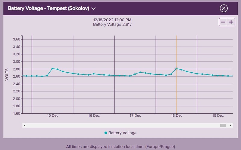

I have been using PBA with AC adapter (240V) since December 5
  • for the first 5 days the PBA kept the Tempest voltage at a constant 2.81V, behaving exactly as described here
  • from about 9th December the battery level in Tempest started to fluctuate between 2.72-2.81V, it was very sunny days when my second Tempest (without PBA) was well charged
  • since about 11 December the Tempest always recharges to 2.81V and then discharges for 2-3 days to about 2.6V and recharges again to 2.81V
  • now for example the Tempest voltage is 2.59V and even though the PBA is connected the Tempest is not charging
  • please note that all the time the PBA is connected and powered from the original mains adapter (240V)
  • the station firmware is version 1.56, Tempest ID 52673
