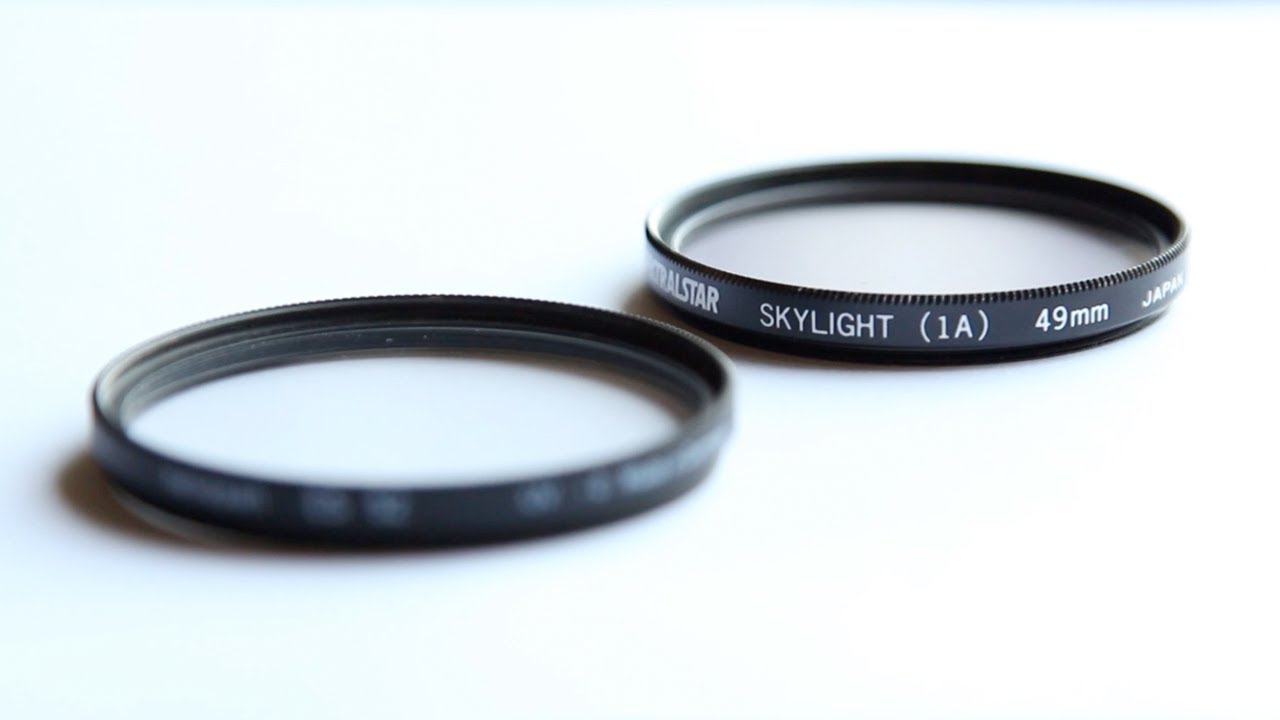

Ian, the skylight filter isn’t a UV filter, see explanation in this video.
Wow @eric,
I didnt realise, so I have done another test this time using a UV filter and will also provide the numbers:
This is the UV reading from the Sky on my roof without any lens over it showing a fairly straight line during the test period:
This is the setup for approximately 3 minutes from just prior to 12:55 and removed prior to 12:59:
This is dip from the Sky covered by the UV filter:
So from this evidence I dont think I can use the Sky UV reading to test how much UV is passing through my lenses.
cheers Ian :slight_smile:
Think I need to dig again in photo UV filters, not sure they are really meant to ‘block’ all but a part that affects colour shift I think. Will look that tonight when I come home
