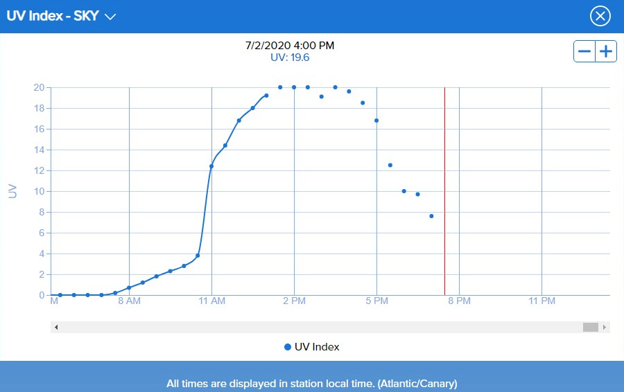

UV index too high?
The Sky is ~5 months new and reported UV in expected range. From this morning, it looks like we’re burning.
Sensor status shows OK but I don’t think it is OK. I have another Sky in the region and shows ~5-6 at the same moment.
Either the UV sensor failed or some algorithm failed.
Clearly a calibration that went wrong. Will ask to get that back ok
Seems that just after solar noon you had a clear drop in sun … mislead the system. Sorry for that.

@petercek You should be back on earth by now, the offending input has been deleted and your UV should be again ‘normal’
Hi there, I checked my Tempest today as well, it reported a UV Index of 25…! I was checking the forum for this same issue…I am in Boise, Idaho. Looks to be back at 6 now, nice clear sky today here! Mike

Have pushed it to the technicians, hopefully someone can have a look soon.
Sorry, hopefully it will be corrected in a few hours.
there you go
back to earth, problem identified but solution might be a little less easy to find but it will
Thanks for bringing it up and if some others have the issue, please post here to get it straight again (manually for now)

Today my Sky (station number 4935) also reported extremely high UV index values. It apparently stopped reporting when it reached values of 20?
And another strange thing is that the points are no longer connected with a line.
