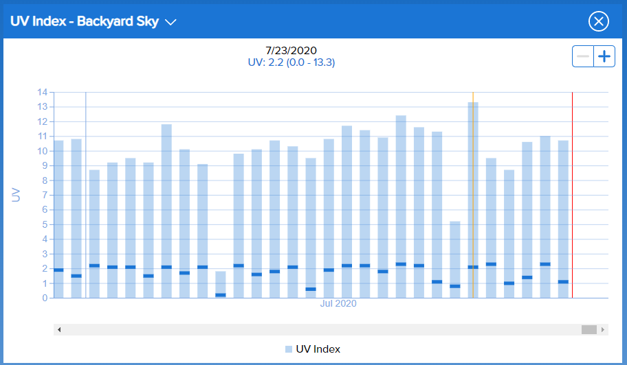

Looking at UV index again today. The script/formula matches the official weather statements (predicting index of 7 at this hour), but Sky is showing index of 10 at the moment. Avg daily max should be 7 for my city.
This is a new Sky unit received in the past few weeks as a replacement. Will have to compare with tempest whenever it arrives.

I have seen UV values as high as 13 last week on my Sky unit, but I suppose that could be legitimate?
Depends where you are I suppose. I’m at latitude 46 (Northern Ontario) so my values are way too high for this area.

Thanks much. I hit UV 12.5 today with the uncalibrated Sky. Geez, I don’t think our northern plants and wildlife could survive with that kind of sun over here !
