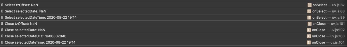

Just tried it here. First attempt said max theoretical UV was 3.94. Clicked submit and nothing happened. Tried again with developer tab open, this time said max theoretical UV was 3.51! Clicked submit, nothing happened. Console output attached. This is in Chrome on Windows 10:
@eric, try again…
@dave, that is fixed now… try again.

@eric, @dave,
Had an error in a copy-paste.
Both reload the page, resubmit and send me the console log.
–Sam
Still doing the first error. Might be because I am being lazy and copy-pasting the date in, then selecting the minute drop down and changing it?
if I fill in location and directly click the arrow to fill the date/time etc, no errors and I can submit (cosole empty)
when I tab in to date and tab out without selecting a date/time so it stays empty you get a logical error
that one must be intercepted later in the code
@dave, again… an error on my part. Fixed that.
@eric, so you’re getting that error when NOT entering a date? I will fix that.
–Sam
Just tried again, all good, no errors and submitted OK :+1:
did it again and not trying to cheat
@dave, @eric… worked for both of you… got your UV reading AND the time!
