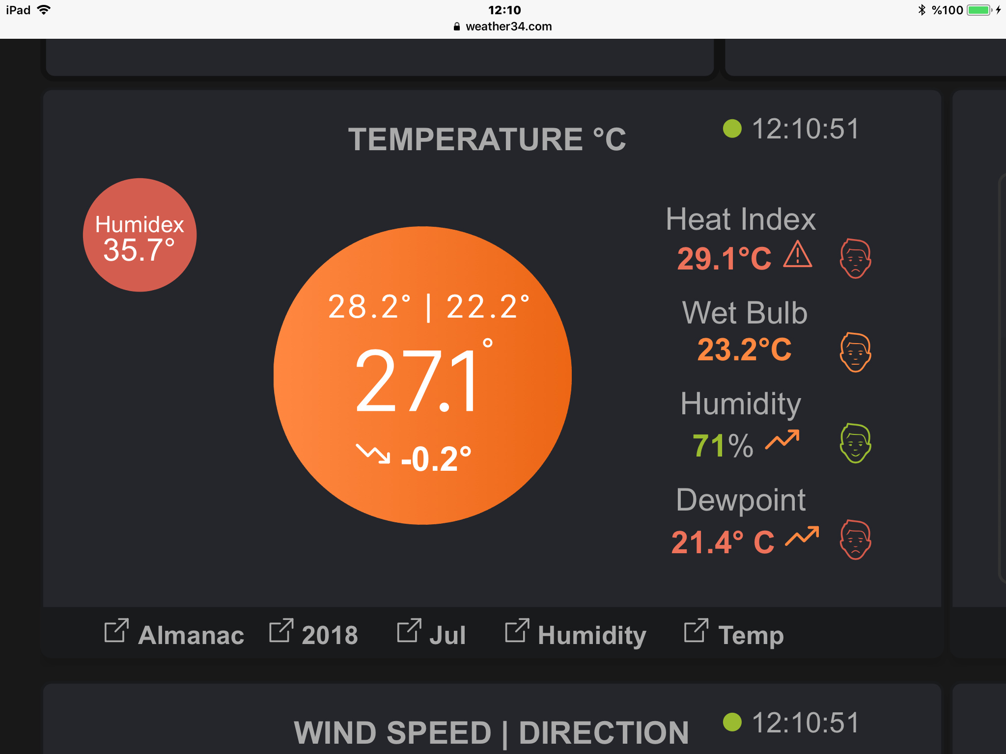

the change is always reflected no matter how small or large in the template.as shown below .
so in short shorter intervals work for me rather than the longer hourly change. image

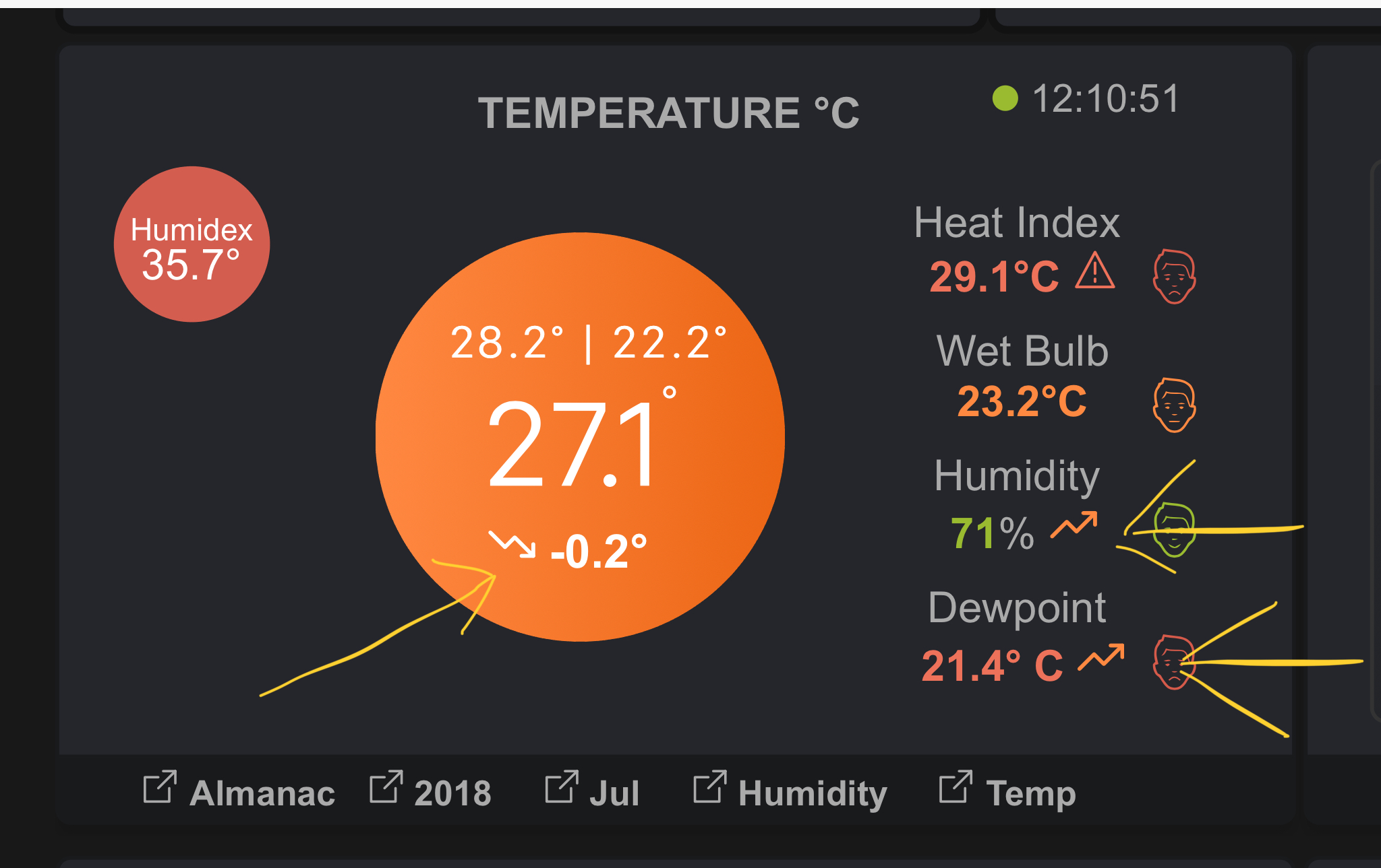

Brian your template looks good but the icon for trend is a little bit off - shows falling, then rising, than falling? Or rising, falling and then rising. Considering your way calculating trend that is not possible. Its falling, or rising.
sorry i don’t understand
If you take your trend-icon as a graph it shows a “history”. First something (fx temp) is rising, then falling and then rising if you follow the trend line. I will argue that the line should go up (rising trend), or down (falling trend).

temperature is faling
humidity is rising
dewpoint is rising
quite simple
No, that is not what your trend-icon shows.
hmmm think your confusing something else i see arrow rising dewpoint,humidity and falling arrow for temperature last 15 minutes.
Your icons shows more than a trend, your icons shows a graph (that shows a history). That is wrong. But ok, we will never agree.

I would use something like this: http://cdn.onlinewebfonts.com/svg/img_452708.png (the arrow) Without ups and downs.
Well the trendarrow by example for tempgoes doown then a bit up and then down I know the intention but strict it says the temp was falliing rising and falling in pint of history (but in my eye of view you can leave it as it is)
i get that part but do the arrows not indicate rising or falling .
ok i agree ron but the arrow does point down or up so i think ill just leave it its been like that for a few years . i don’t disagree ron your quite right but i dont see it will make a lot of difference.
