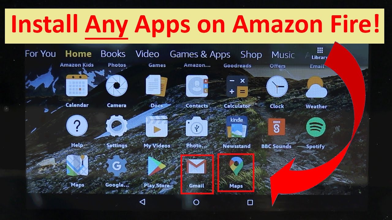

Two days later I had the Fire in hand and here’s where it gets hairy… Amazon Fires do not come with Google play Store even though they run on Android. So a little research and I found this below.
Turns out you have to download four APK files that are required for your specific Fire tablet generation and size. They have a table with links to the correct APKs but it is a bit confusing. Otherwise if you follow the instructions and obtain the correct APKs, everything works beautifully.
There is also a Youtube tutorial which covers this and you might want to view it first.
