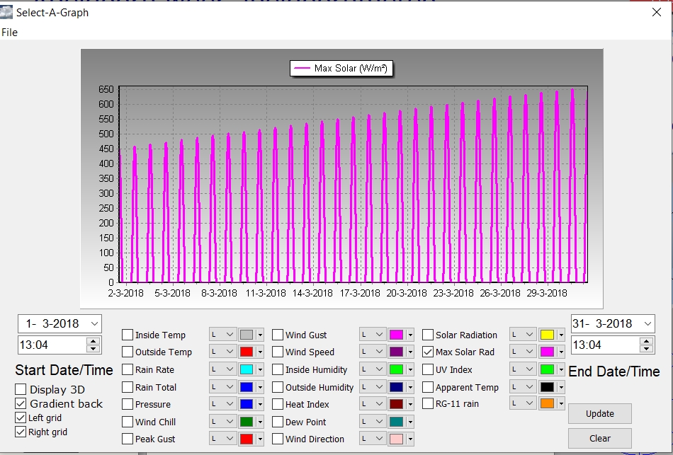

Cumulus V1.94 for windows software has a built in option to display a graph for max solaradition based on this page (Ryan-Stolzenbach) excel spreadsheet availble https://ecology.wa.gov/Research-Data/Data-resources/Models-spreadsheets/Modeling-the-environment/Models-tools-for-TMDLs
The generated graph by cumulus is close to my script mentioned before and does not exceed 700 W/m2 in March maybe it has too do with the cloudreflections and high UV as mentioned before …
