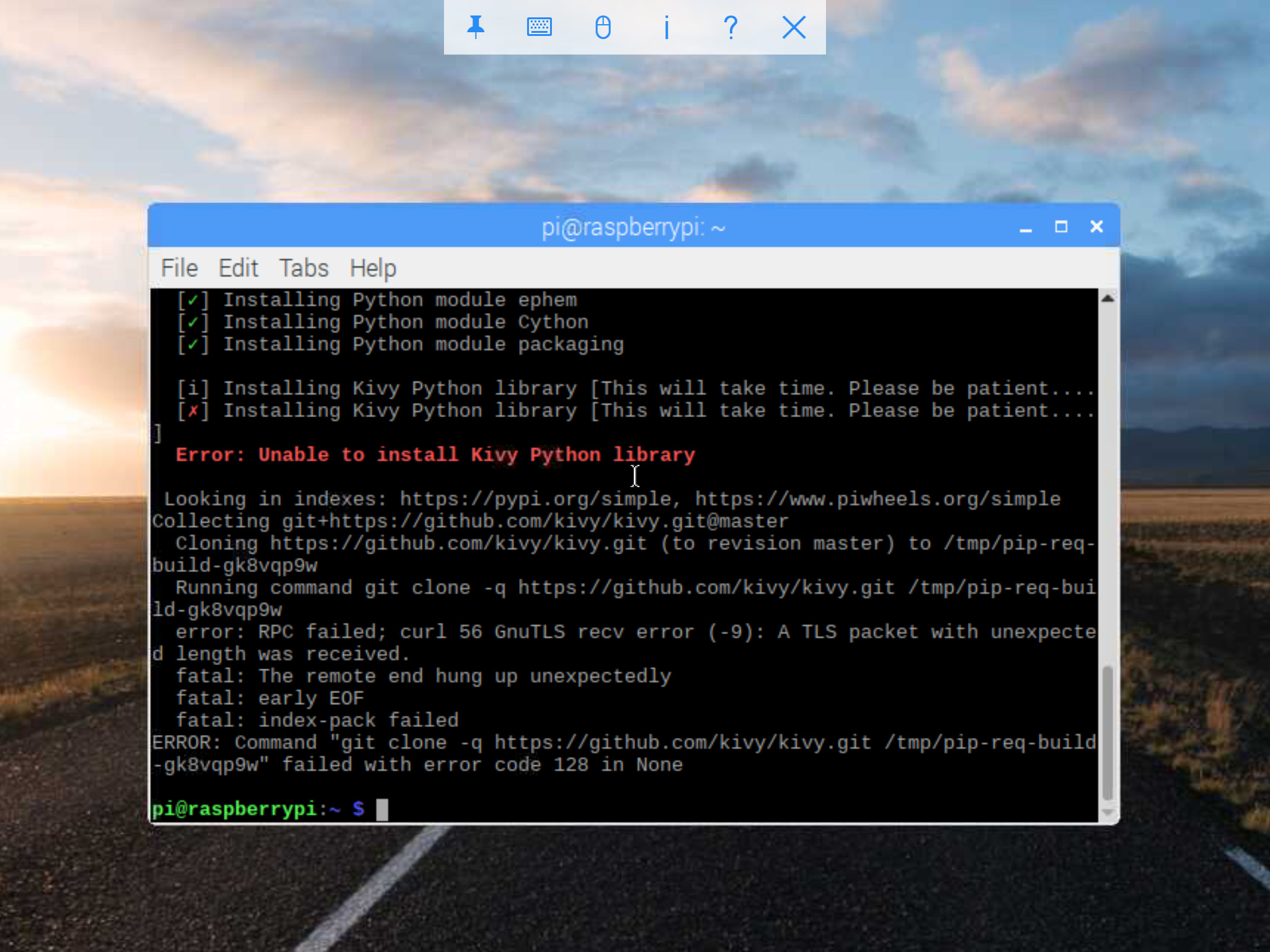

I’ve followed through the auto install instructions. Everything works fine until it gets to the stage of installing Kivy. It’s at this point it falls over and the installation of Kivy fails and it ends the installation. Screenshot (literally!) attached.
I’ve tried this several times on a Pi 2B and 3B, each time with clean installation of Buster with the same results. I was wondering if it could be something to do with Raspbian Buster being very new, and possibly not working 100% with other programs yet? I just thought I would post and see if anyone else has tried to install this recently and hit similar issues?
Equally, I should mention that I don’t have an LCD screen installed to my Pi, I was hoping (if possible) to use the HDMI output to a screen on our wall, if not I will buy a screen. Not sure if this would affect the install process?
Hi Alex! Thanks for checking out the PiConsole . I hope it comes in useful for the Sea Cadets.
I haven’t had a chance to test the console with Rasbian Buster yet, but I imagine that this is what is causing the problems for you.
Fortunately, you can still download the latest (previous) version of Rasbian Stretch here: Index of /raspbian/images/raspbian-2019-04-09 (the file you want is 2019-04-08-raspbian-stretch.zip or you can click on this direct download link: http://downloads.raspberrypi.org/raspbian/images/raspbian-2019-04-09/2019-04-08-raspbian-stretch.zip). You flash the image to your SD card in the exact same way as you did with Rasbian Buster. Would you be willing to see if the installation works with the Rasbian Stretch image and let me know the results? This will help confirm whether Rasbian Buster is the problem. Cheers!

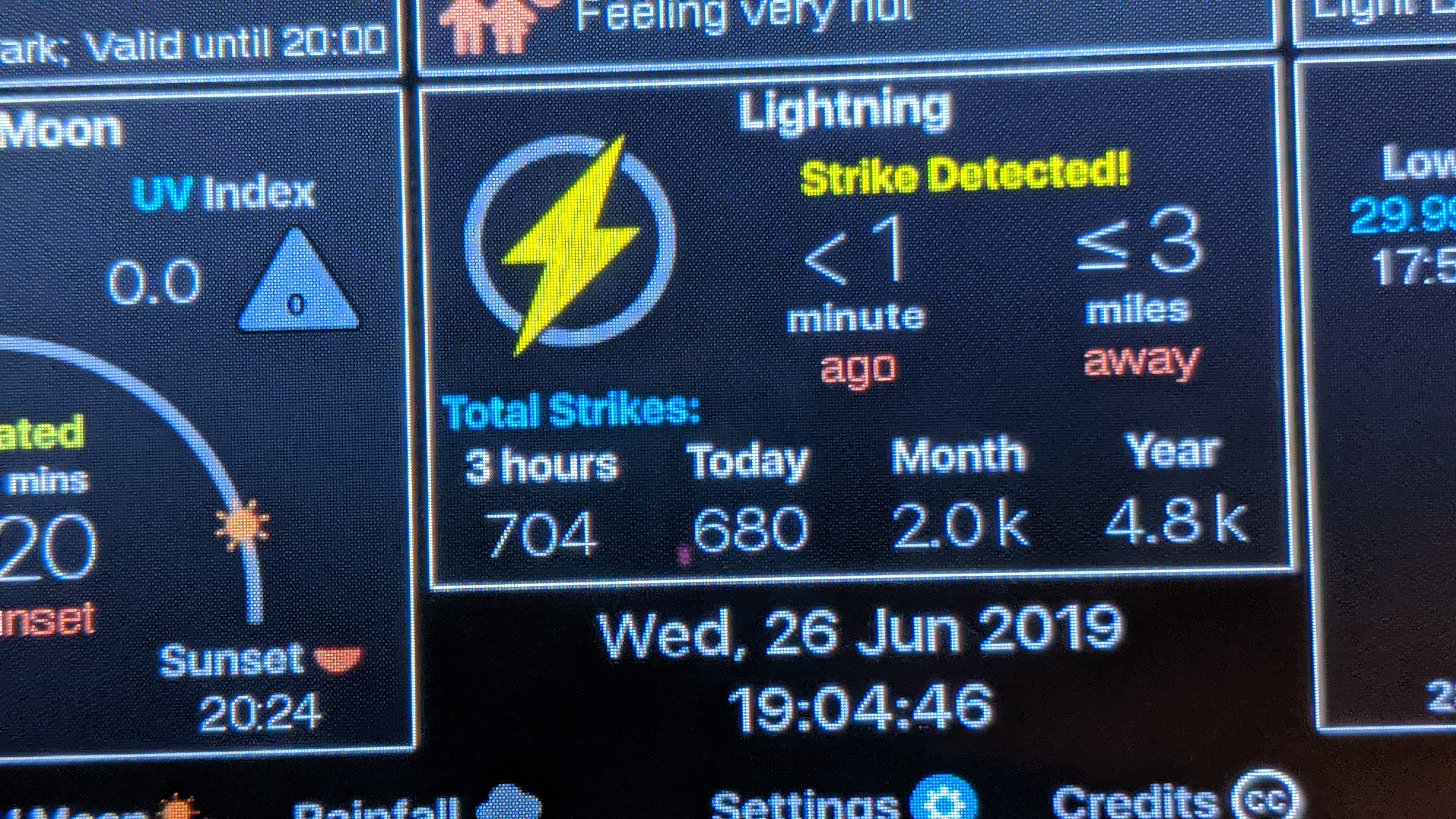

Good question! Both the “today” total and the “3 hour” total are calculated each minute, so it seems odd that they have got out of sync. The “3 hour” total uses the strike_count_3h API field, while the “today” total is calculated locally on the console. Let me have a dig around and see if I can find anything wrong. Unfortunately lightning is quite rare in the UK, so it is the hardest part to debug!

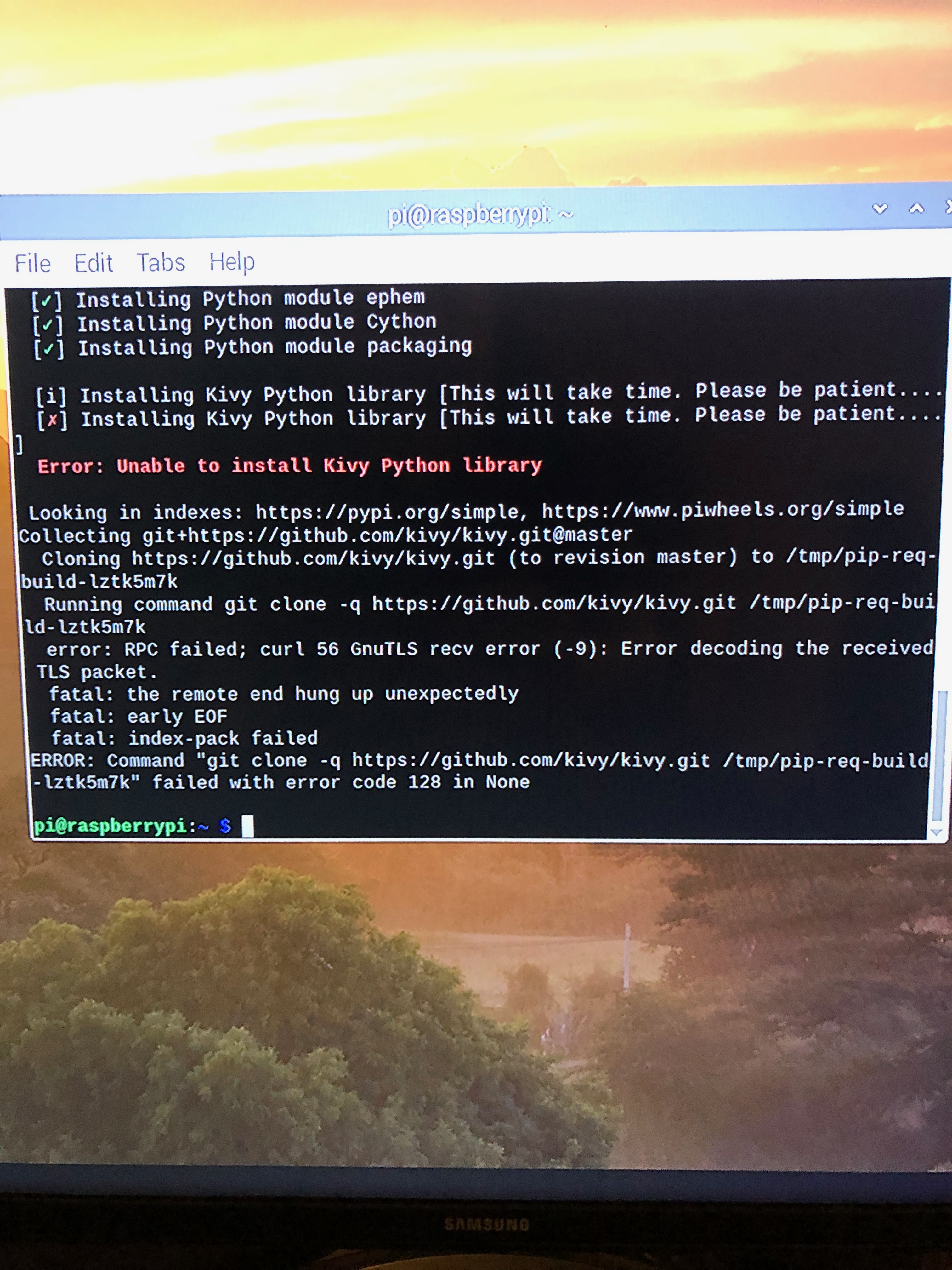

Hi Peter, tried again using Stretch but still no joy keeps falling over at Kivy install, tried 3 times each with brand new flash. Can only assume it must be something related to Kivy? Screenshot below. If anyone can shed any light on this it would be much appreciated, thanks all.
to me the error mentioned says that the download is or interrupted or the file on the git isn’t complete. In any case that’s what I understand from it. Now why ??
Yu have a slow or unstable connection (wifi for ex) ??

I figured out the problem. I lost power for a couple seconds today and the Pi rebooted. When it came back on it had lost the Lightning Today and Rain Today numbers. It must have rebooted in the first case and I didn’t know it.
