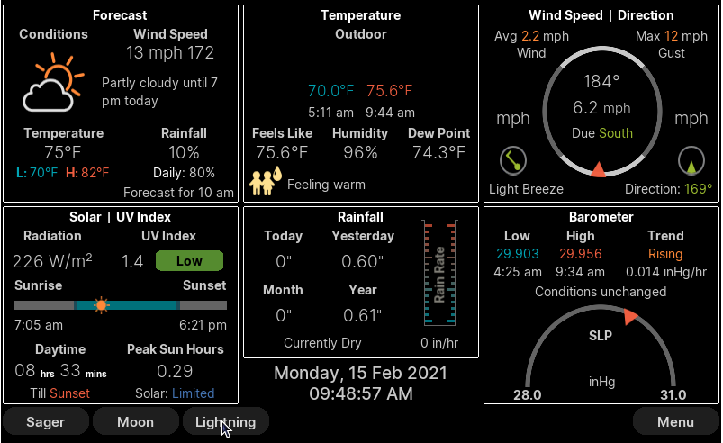

updated both my setups … one SKY/AIR & the other Tempest
The one setup for Tempest - I get no longer get an Outdoor temp display - LARGE reading. This continues after launch…and running.

{Edit: noticed it’s ALL those LARGE Fonts}
Great! Glad you managed to get it fixed. Sorry it broke though. Sounds like something got corrupted unfortunately. Can you run as test for me? Make a backup of the working folder and then try running the update command again. Nothing should change, but it would be interesting to know if the bug/corruption happens again. It it does, I will investigate and you can roll back to your backed up version.
I had done that prior to my other efforts. It stated no update required - or something to that effect.
That makes sense as the current and latest version numbers match. If you run the update again now though on the working version, does the console still run afterwards? Just trying to work out if the update command will always break your installation
Ok, did that …and it’s running fine …
  [i] Latest version of WeatherFlow PiConsole: v4.0.3
