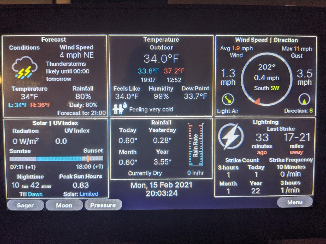

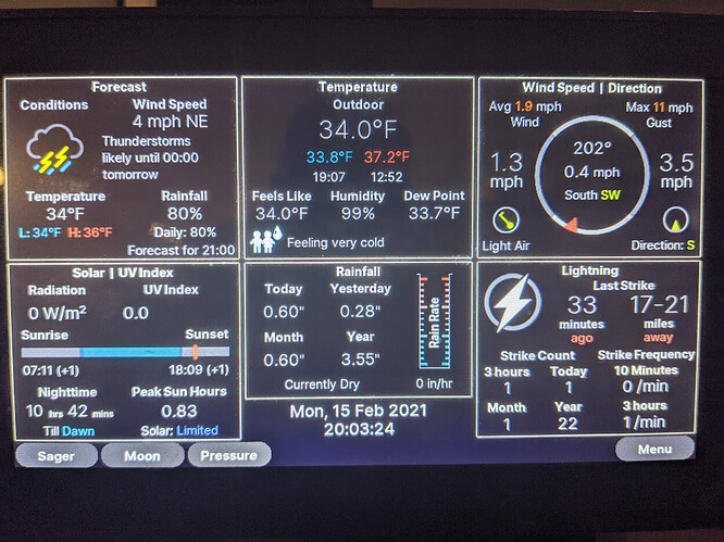

For the eagled-eyed amongst you, you may have noticed that when the UV index is zero, the coloured bar disappears. This was a mistake :frowning: . I won’t issue a new version to fix this bug (it’ll get rolled into the next release), but in the meantime if you really want it back you can run
wfpiconsole patch
to make the necessary changes to code without bumping the version.
Got an issue with the rain accumulation in the new version. The month value is not right, it is just showing the same value as today.
Indeed, I see the same this morning.
@Peter will solve that soon for sure
Thanks for the bug report. I will take a look into it. If you stop and restart the console, do you still see the same behaviour?
Yes, stoping and restarting still shows the same. I even tried rebooting the Pi and that didn’t work either.
OK, I will take a look into this
Works here perfectly without the patch
