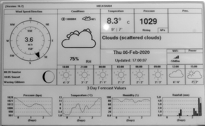

Haven’t you thought of using an e-paper screen instead of the RAspberry LCD screen?
I came across an interesting project
: GitHub - G6EJD/ESP32-e-Paper-Weather-Display: An ESP32 and 2.9", 4.2" or 7.5" ePaper Display reads Weather Underground data via their API and then displays the weather
I am trying to adapt the program to raspberry but my skills are very limited!

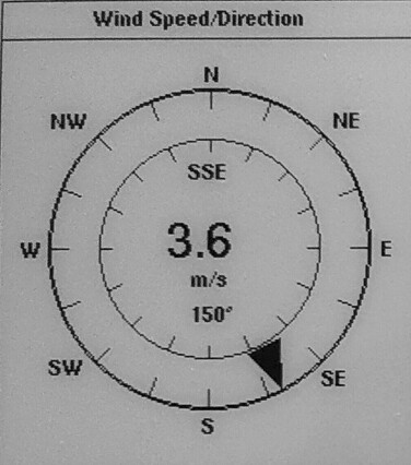

The Wind Speed / Direction section looks very cool. Thats a good idea to improve the Pi Console. Another nice section to add to the Pi Console could be the WiFi signal strength (not sure if its included in the current WF API) and the battery exposed in the main screen.

I agree that the e-ink screens look good, but this is very unlikely to happen. Converting the PiConsole to run on an e-ink screen is basically a brand new project, a with complete re-write of the code required. Sorry!

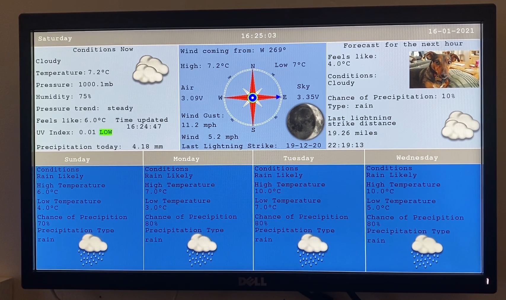

This is my attempt at a display
I don’t know Python so it’s all written in Basic - 19inch hdmi monitor the photo isn’t brilliant but it looks better irl

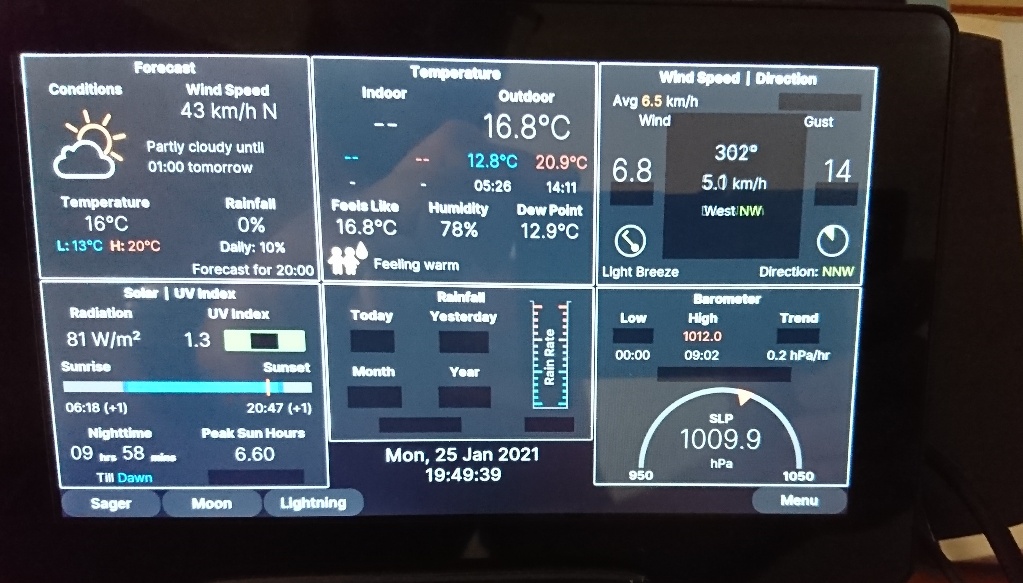

I have a problem with my display, at times random things will display as blank and the wind direction compass display only for about a sec before it dissapear for a while and come back and disappears.
At times the buttons may disappear or the button may take a while to open aka menu
I orginal thought my raspberry pi had conflicting software so formated my sd card install the latest raspberry pi with desktop OS and made sure it’s all upto date before installing the console everything but it didn’t fix it
I have raspberry pi 3B
I’ve check my pi CPU, ram and it looks like it’s not under anyload
nothing weird, and rather simple to solve, try this solution. Worked for me
https://community.tempest.earth/t/weatherflow-piconsole/1933/617?u=eric
Thanks for that.
I change the memory to 128 which fix most things but the wind gauge was flickering but less than before.
I then change it to 256 and so far so good

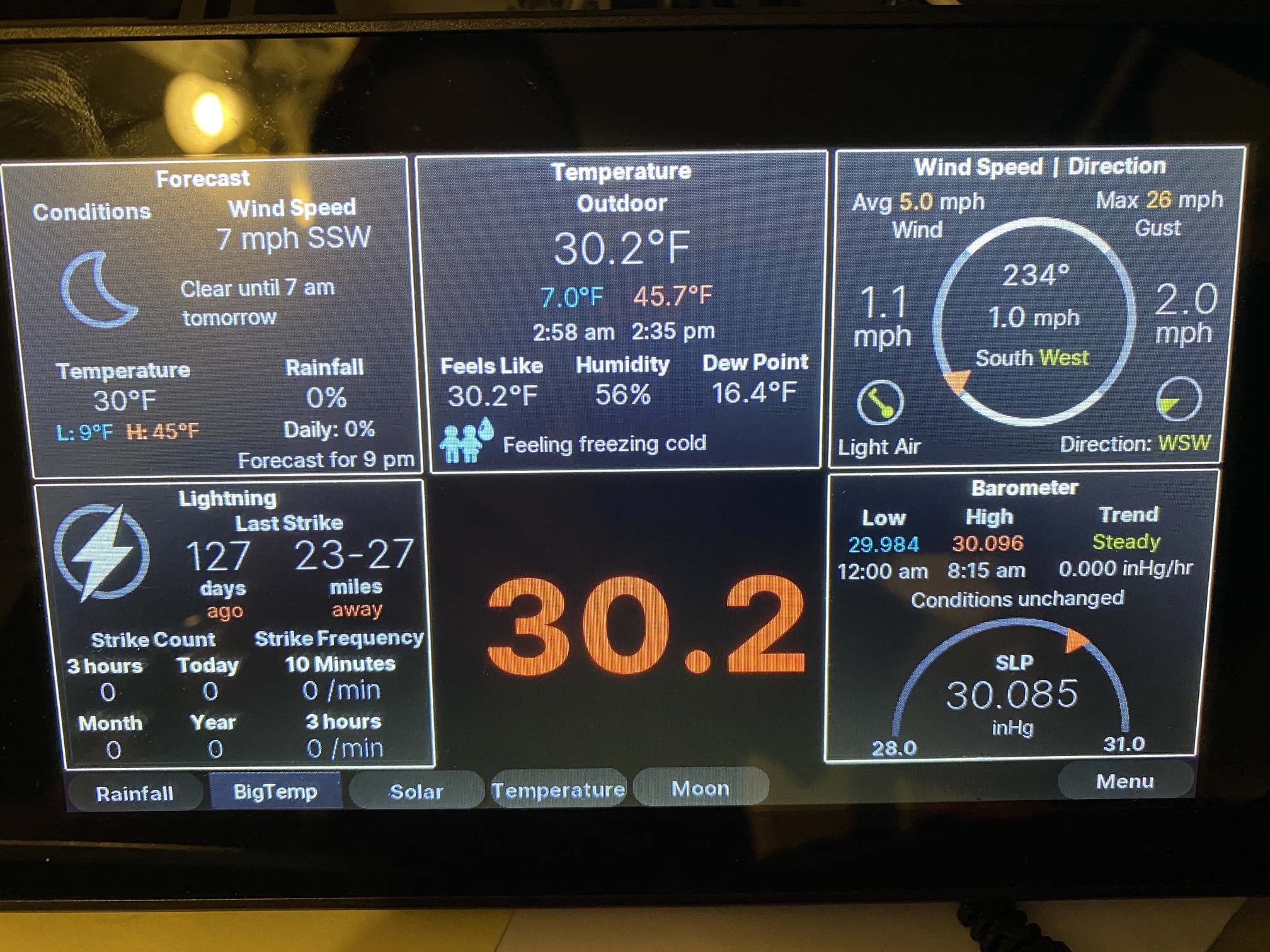

I’m curious if anyone can tell me how to make the background a true black so that there is a better contrast ration between background and the text/images.
After installing @stevecody 's big temp panel it appears that big temp is using a true black background that is easy to contrast against the numbers whereas everything else is slightly washed out.
or is there a way to remove the border from the other panel images? might just be too much white
Where can I find details of the Big Temp panel…??
it looks great…!!
To make this change you’ll need to edit line 88 and 109 of kvlang/panelLayout.kv to read rgba: utils.rgba('000000ff').

Thanks Peter. Sooo much easier to read. You should consider making this default.
Brilliant…!!
Had a few minor hiccups (all user error) but have made both changes successfully.
Once Weather Flow have sorted out an internal temperature sensor - it would be great to add a large display below the BigTemp indication, but on the same panel.
Perhaps in light blue to easily pick which is which.
Both the change to a darker background & the BigTemp panel are great improvements.
