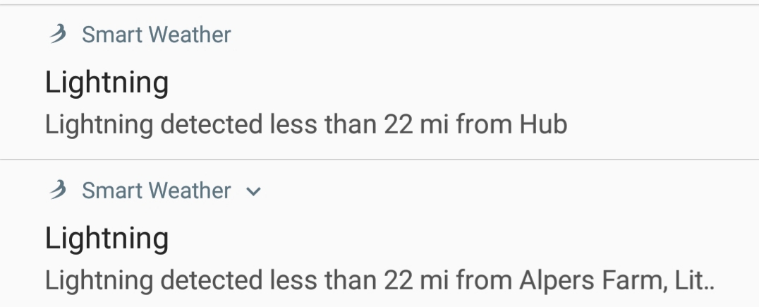

I have 2 Air modules via 2 different hubs, the 2 modules are about 2 meters apart.
About 40 minutes ago (I wasn’t home but I can confirm with Blitzortnung station) we had a few close impacts detected.
But the 2 modules give other results and count, maybe the fact they are both on my account makes the server go in loops ? Signals would have arrived on the same time on server …
air 4384 detected
15
58
and air 7487 detected
29
39

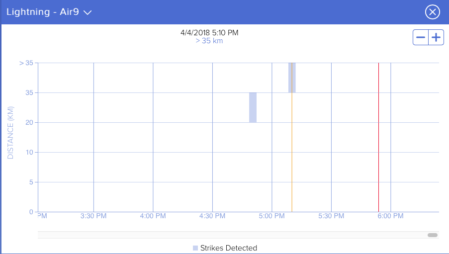

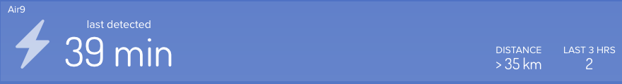

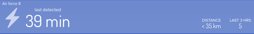

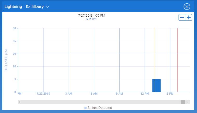

The Air (AR-00011341) unit that my parents have has had a problem of detecting false positive lightning. I spent quite a bit of time moving it around the property but there was no improvement. In the end, I disabled the lightning notifications.
I currently have it alongside my Air (AR-00005248) for RH calibration. It’s at work and there is a lot of electric equipment nearby so I expect some false positives but my parents Air is detecting way more (930 vs 202). Try did different orientations.
So I’m wondering if Weatherflow can apply a software calibration or de-sensitisation to a lightning sensor?

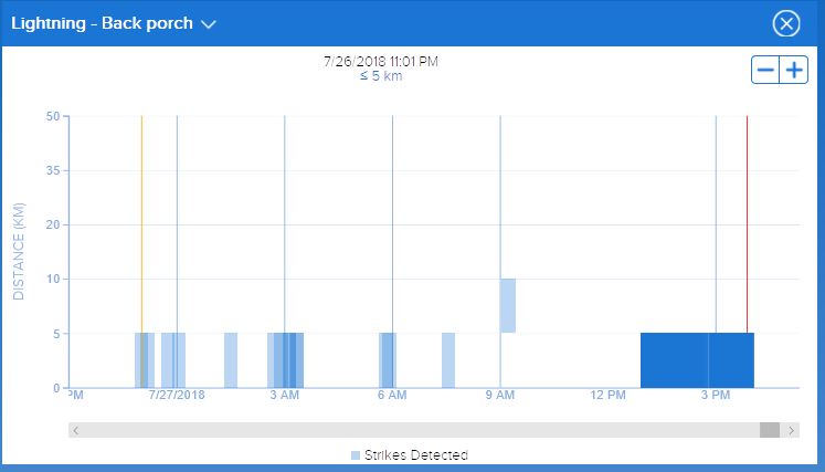

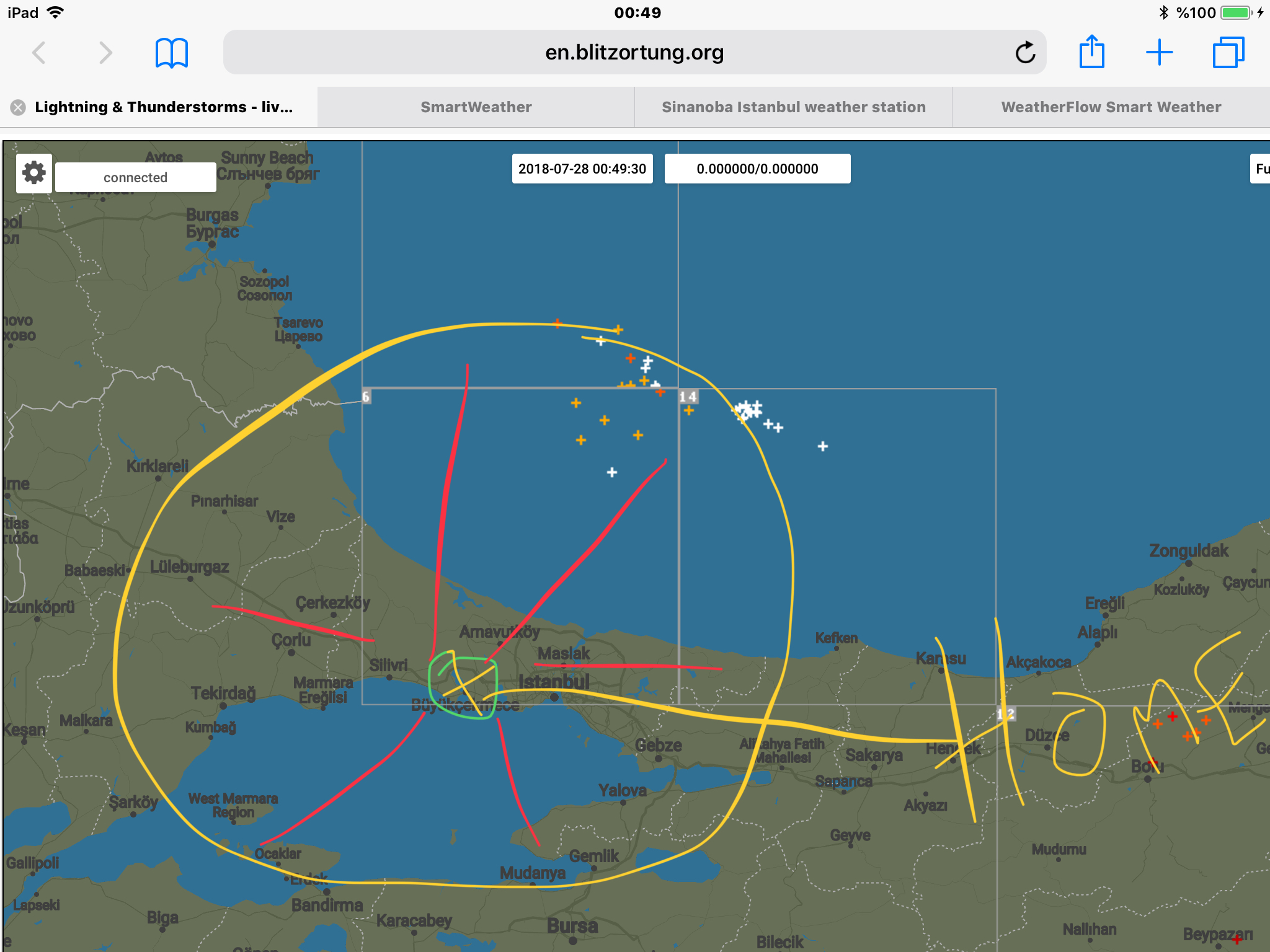

hello i was going to reply yesterday but was side tracked,anyway i spent over 3 months testing out various locations around our property to find the optimum position of a production air model for lightning. suprislingly the production model mounted horizontal gives me optimum results , this goes against the recommendations of mounting vertically. i also have an old beta model air from early 2017 mounted horizontal both these units are optimized the production air for northerly and beta for southerly . mounting either if these vertical as recommended on the production model produces very poor results unless the storm is on top of you or 5-10km .
for example today we had a storm moving in from the northerly direction it recorded 1900 or more strikes then later in the evening the southerly optimized unit kicked in as the storm shifted south and the northerly optimized unit went quiet .
as i said above i have spent months using these and after much trying of various positions i finally found the sweet spots . these units seem to have a very sharp lobe in directions .
this my capture arrea and currently the northerly optimized horizontally production unit is starting to kick off ! just keep trying and look for the sweet spot…the trade off might be adverse to temperatures .imageimage
