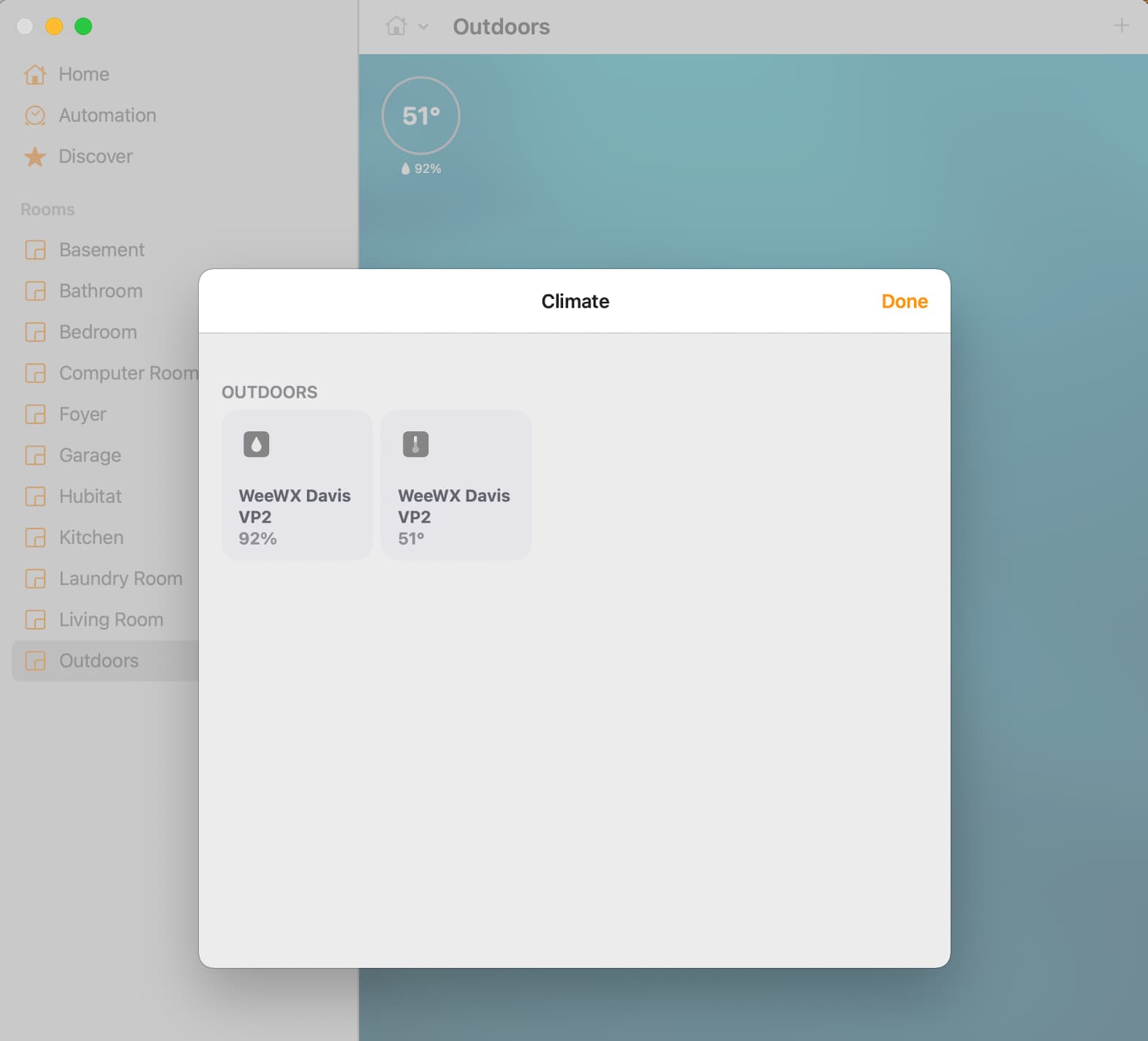

HomeKit does support outdoor temperature and humidity, which are valuable data points for home automation routines:
That’s true, HomeKit does provide some support for temperature and humidity - thanks for the correction @vreihen. I should not have said it doesn’t “support outdoor weather parameters” because HomeKit doesn’t care if your T/RH sensor is indoors or out. What I should have said is that HomeKit does not currently include the concept of a weather station, nor any parameters a weather station measures other than temperature & humidity. The T & RH services are grouped with HVAC stuff (thermostats, heaters, coolers, fans, filters, etc).
More importantly, the other issue is that HomeKit support is limited to viewing T & RH values in the Home app. So (unless something’s changed recently), you can SEE the values in your Home app, but you can’t USE those values to create automations or do much else because they are not considered “triggers” by HomeKit or the Home app. If that’s not true, please correct me.
