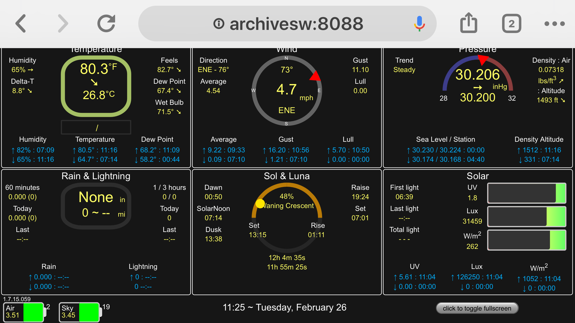

It would seem there is a timezone issue between them. Is the timezone correct on the computer?
here is a screenshot from my iPhone - same issue
iphone

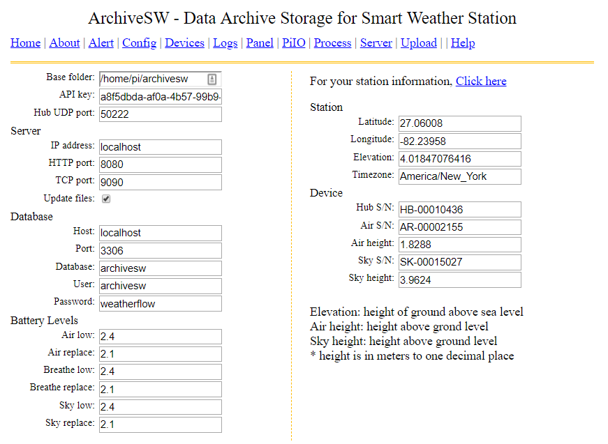

Send me a screen shot of your Config tab from ArchiveSW.
I have no clue why the time is so far off. Go to the Process tab and Restart the Server process. I don’t know if that will correct the issue but it’s the only idea I have at the moment.

I have no clue. It’s JavaScript on your computer that converts and displays the time. I can turn on debugging and see what raw data is being returned.
ok … no need to put on a to-do-list or anything. I’m just providing feedback. Perhaps at some point something will click.
I have displayed on two different computers (PCs) plus my iPhone. I can try on my other devices at some point, Android tablet, iPad, etc. If I have additional (that may help resolve) info, I’ll get back to you.
Restart the Panel process and see if that changes the times.

not to be a pain … but I also noticed a parameter I’ve not paid much attention to before , and is new to me - I’ve noticed it in the data that I’ve collected prior to me setting up ArchiveSW. I have a crude archiver I built that imports data into a MySQL dB… Air Density. On your panel screen it shows 0.7337 ?? and then on the bottom of the section shows 1808.
my data records show different values – is there a conversion going on with that?
There is Air Density and there is Density Altitude. Those are two different calculations. And both are dependent on elevation and localization.

The air density you have stored is in kg/m3 and ArchiveSW is displaying the value in lbs/ft3 so that’s the difference in that value.

I was just threading back up … and saw your message - the one on restarting the Server - must have transposed my brain - when re-reading.
I see now you told me to restart the Panel after that!
BINGO!
I’m guessing the Panel was started before the configuration was set.
