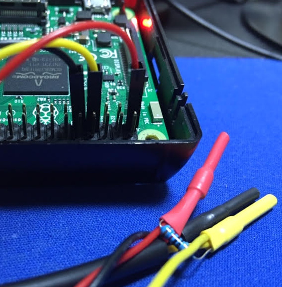

I need a little help getting my new sensor (DS18B20) working -
I wired to the GPIO - red lead to PIN#1 (3.3v +), black to PIN#9 (GND), yellow to PIN#7 (GPIO4). I have a 10k resistor between PIN#1 & PIN#7(GPIO4).
I ‘added’ Piio under Process manager - and under PiIO I checked ‘active’ all triggers not checked. (saved) I then started the process.
I don’t get any data on the panel display - and while the process is running - it continuously shows restarts increasing? (currently over 114) after refreshing screen.
can you help?
(edit) - also under PiIO screen on the right side - shows:
Sensors
28-0206924563d8
(running on an Rpi 3B V1.2)
