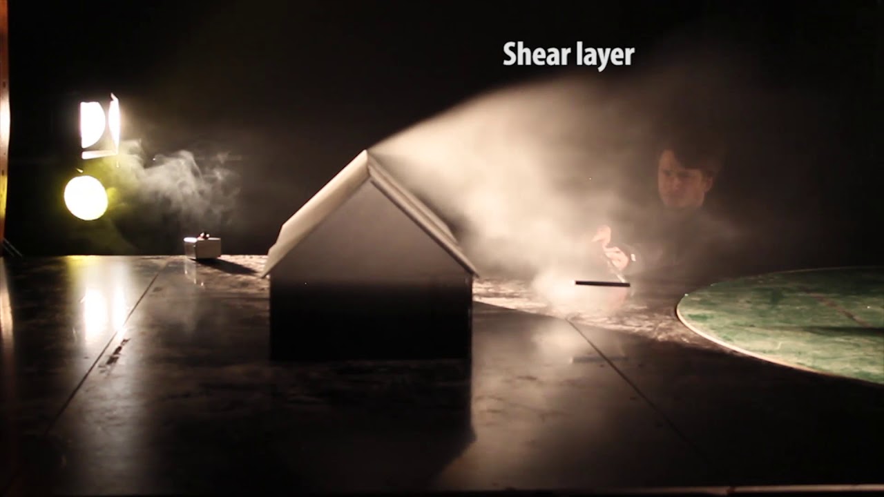

Check out this video to get an idea of what wind patterns are like around buildings.
Thanks! @tony.mcgee looked at my data and it looks fine. He did tell me that the station could possibly catch some of the turbulence. But so far, it hasn’t caught any of the turbulence (as far as we know). The data is very representative when the wind is blowing from where turbulence would most likely happen. But other than that, it’s in a great spot to record some wild data without having vibration issues. But I do appreciate everyone’s input on here.
