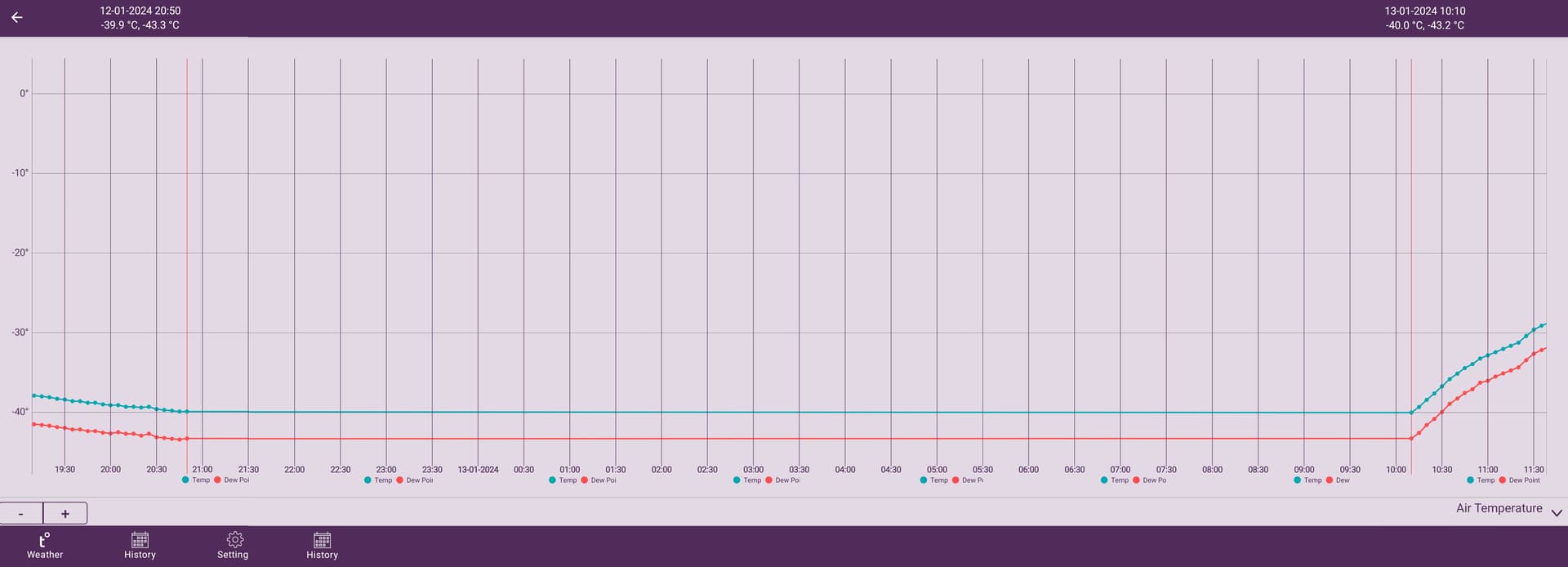

Southern Saskatchewan here. Regular thermometer is -40 but the Weatherflow/Tempest stopped showing a temp when it hit -40. Graph went off the bottom and a blank — appears where temperature reading should be. Is this normal? Batteries say good, other things seem to be recording. In original post mlandfarm above was talking windchill. This is real is temperature.

As I understand, to prevent invalid temperatures from being shown, the graphs should not display any temperature data below -40 F/C. However, it seems there are some inefficiencies handling the null data, where it appears it’s being plotted at -40 F/C. Ideally the line should not be present and there should be no data points.
