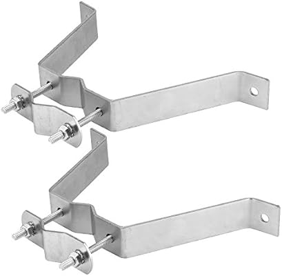

Matt, where did you find those brackets?
I found them on Amazon…got the pole at a local ACE hardware…

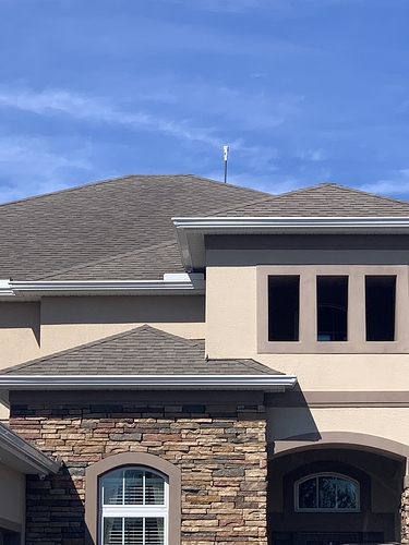

lovely clouds and nice picture overall
