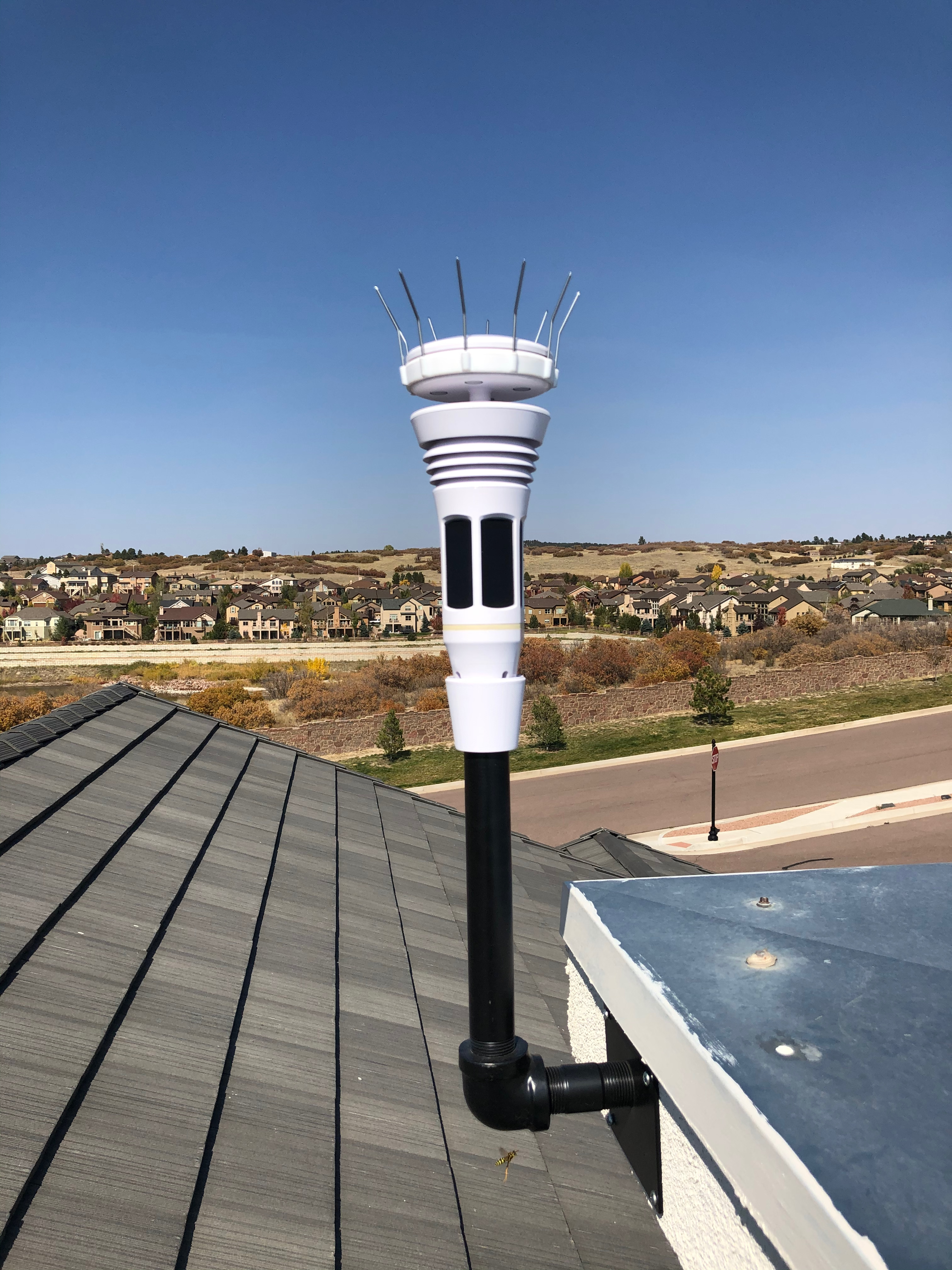

Mounted using a 13” threaded 1” aluminum length of pole into a 90° aluminum bend into a 3” that was attached to a 4” 18 gauge aluminum square (yes I wanted to make sure the house didn’t become a lightning rod). Then mounted it to our faux chimney where it’s the absolute tallest point on the house. Get great readings for wind, rain and temp with no issues reaching the base station in the livening room 20’+ below.
Updated photo after installing my anti-bird crown :+1:t2:

Seen the picture you will most probably have heat radiation from the steel plate (and concrete) and most probably a temperature reading too high.
Also your wind readings will be biased by turbulence depending where the wind comes from.
Next to that, nice view
So far my temp readings compared to other local WX stations (1-3NM area) are within .2° degrees of all others. Both my mounting pole and the “plate” across the top cap of the faux chimney are Aluminum and not Steel, therefore the overall heat radiated is going to be lower than steel and as far as the concrete roof tiles, I can’t help that but that are not causing a noticeable increase in temperature readings. As for the wind turbulence, compared to the other WX stations in the area, again it’s within +/-1mph and is in the best possible position based on other structures in the area and normal wind patterns to collect correct data.

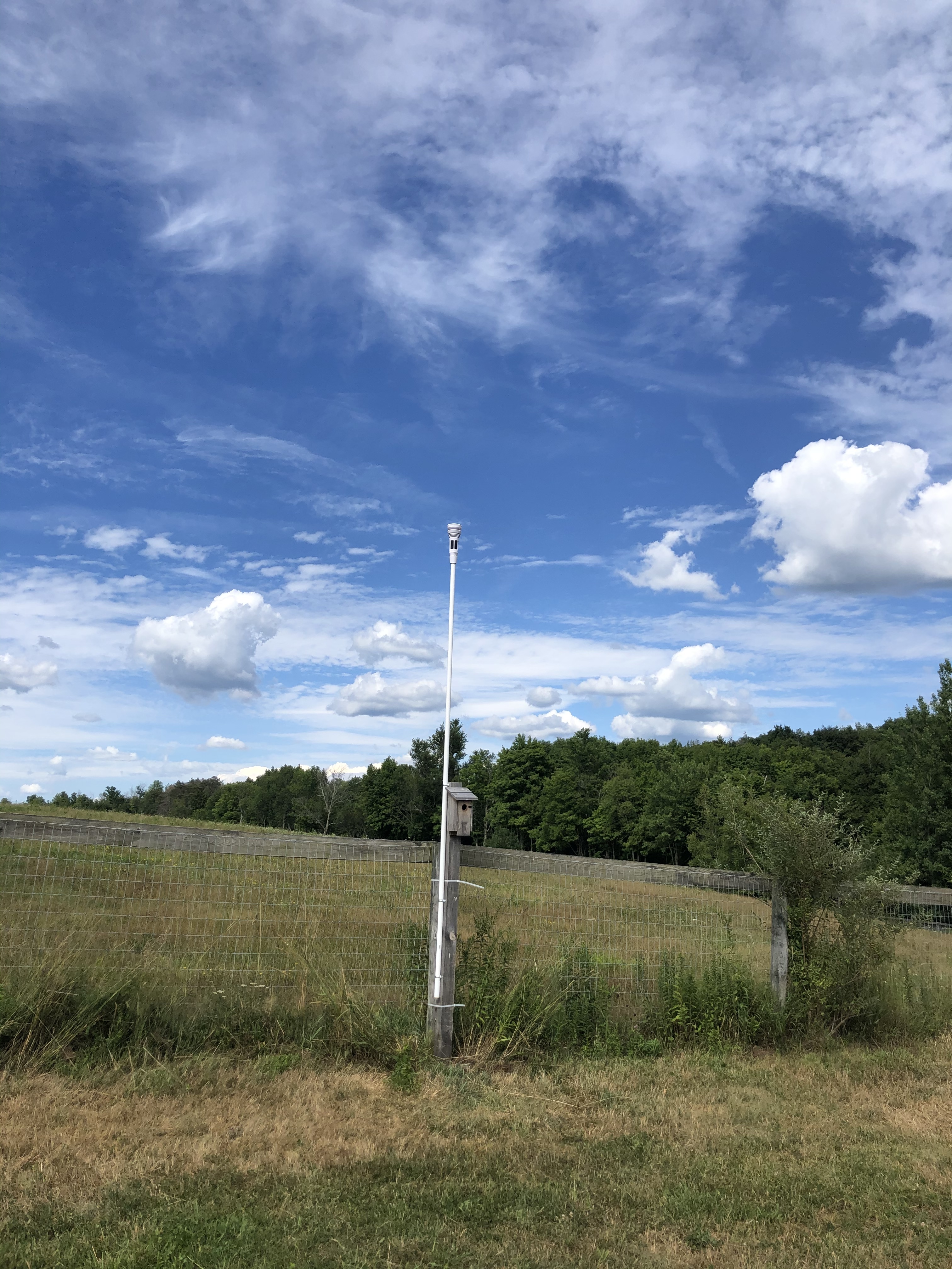

Set up a Tempest at my parents house today. Quick and easy using a vinyl wrapped closet rod and they are up and running. Hope they don’t need a bird deterrent but I better order one just in case! :joy:
Better safe than sorry. Lol. I ordered 2 of them not long after the announcement.
Put out a sign with an arrow (pointing down) directing the birds to the little house below. . .and Not the item at the top of the pole!
Wow that looks like quite the set up!! Nice!
